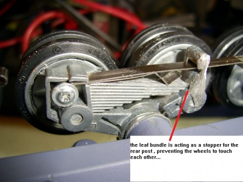

I think the reason why Sturnmd cut the spring was to remove ther "O" stop on the end doesn't look like it needs it ...hopefully he can clarify

It could be done without removing the suspension from the chassis: -Remove the clip by sliding it toward the back wheelMichaelC wrote:strmnd45,
Good video..... couple of questions though:
- Do you think I can do this without taking the suspension assembly off the chassis ? I assume that you have to remove the clip that holds the leaf springs together.
- Would it work if I just bend the second leaf spring but not trim it ?
- Does this "lift" the chassis up then before the mod, or simply give the boggies more give ?
MichaelC.
- You can then take the leaves off the assembly
I would cut the second leaf because the suspension is now using the leaf bundle as a stopper when on rest position
This mod also raise the suspension and give more ground clearance to the lower hull
It's quite a simple mod; here's another pic that can help:

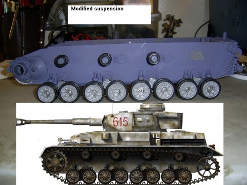

In my opinion, the stock suspension is riding too low...
Even after softening the leafs, there's too much space between the wheels on each posts; leaving not enough between the wheels of 2 adjacent posts...
Trying to compress a suspension like this will result of the rear wheel of one post rubbing against the front wheel of the next post...
Here's 2 pictures comparing the space between the wheels to the real thing; before and after the mod.
