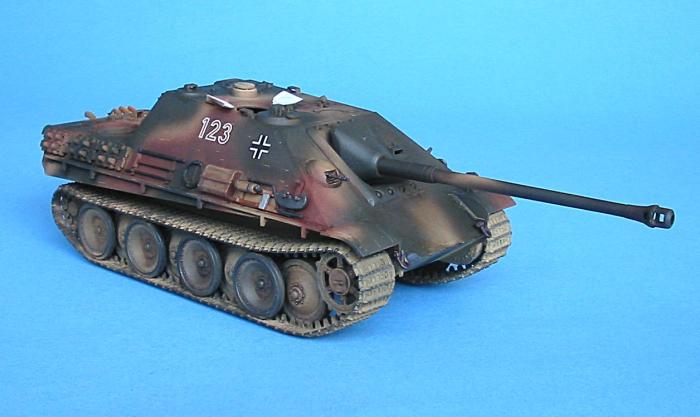

What kind of color scheme are you going to do?
Re: Lert's JagdPanther
Probably. That's a good idea, actually. Just need to get rid of the node and fill up the hole.ALPHA wrote:Hey Lert ... nice Job ... you planning on relocating the Antenna?
Something like this:ALPHA wrote: What kind of color scheme are you going to do?
Or similar to. I like three-color woodland camo. Probably not going to bother with the 'measles' that I put on my Pizzle IV.

Cool paint job... can't wait to see the finished tank
