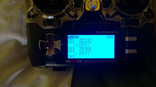

Also a pic of your mixer screen as it is at the moment would help.

Yeah I ment the throttle and turret rotation are assigned to pots, my bad! Its set to mode 3, I will try put a picture of my mixer screen on tomorrow, your right it would be easier in person, take me about 5 hours to get down south, shame really as I don't know any other tankers/clubs/ battlefields in the midlands!

hey paul heres a pic of my mixer setup at min
I have my sticks setup the same as you, just that diagonals on the left stick controls, smoke/lights/momentum/engine start.
I have this lables for the switches on my home screen, just need to link them to the function.
am assuming I need to insert a mix, just not sure on what channel on the mixer screen and what settings etc
cheers

Ok, Thas looking good.
I will assume that you have gone through the IBU set up of the stick movements using switch 8 on the IBU (page 11 in the IBU2 manual).
If not carry out this procedure before going any further. This just lets the IBU2 know how far the sticks travel.
If you wish to keep the functions (including Canon and MG) on the left stick and have them on the switches, then leave Ch3 at 100 GUN. If you only want these functions (including the Canon & MG) then set CH3 at 50 Gun.
Change Ch4 to 100 TUR
Now to add the switch mixes.
Scroll down to CH3 and press menu. select insert. set source to half. set weight to 100. scroll down to switch and set this to CAN.
Exit.
Scroll down to CH3 and press menu. select insert. set source to half. set weight to -100. scroll down to switch and set this to MGN.
Exit.
Scroll down to CH3 and press menu. select insert. set source to half. set weight to 100. scroll down to switch and set this to XGN.
Exit.
Scroll down to CH3 and press menu. select insert. set source to half. set weight to -100. scroll down to switch and set this to ENG.
Exit
Scroll down to CH3 and press menu. select insert. set source to half. set weight to 100. scroll down to switch and set this to SND.
Exit
Scroll down to CH3 and press menu. select insert. set source to half. set weight to -100. scroll down to switch and set this to AUX
Exit.
Scroll down to CH4 and press menu. select insert. set source to half. set weight to 100. scroll down to switch and set this to XGN.
Exit
Scroll down to CH4 and press menu. select insert. set source to half. set weight to 100. scroll down to switch and set this to ENG
Exit
Scroll down to CH4 and press menu. select insert. set source to half. set weight to -100. scroll down to switch and set this to AUX
Exit
Scroll down to CH4 and press menu. select insert. set source to half. set weight to -100. scroll down to switch and set this to SND
Few!!!! we are there :D :thumbup:
