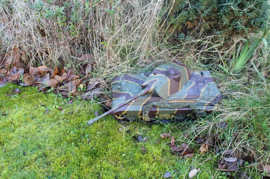

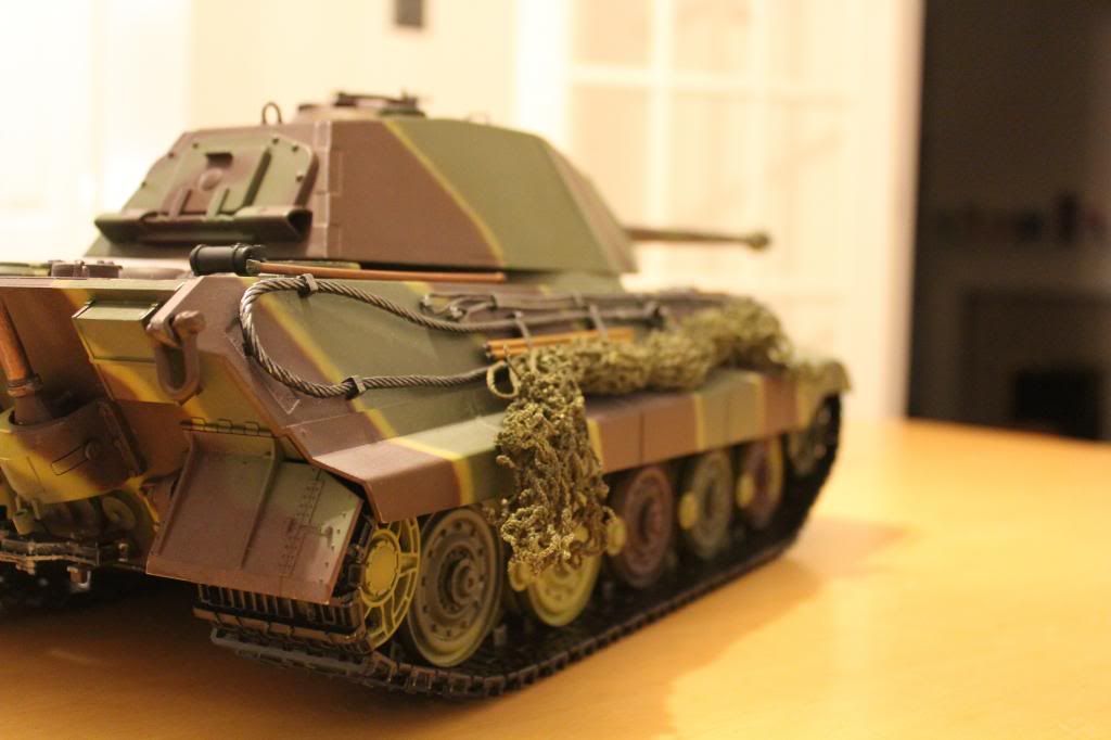

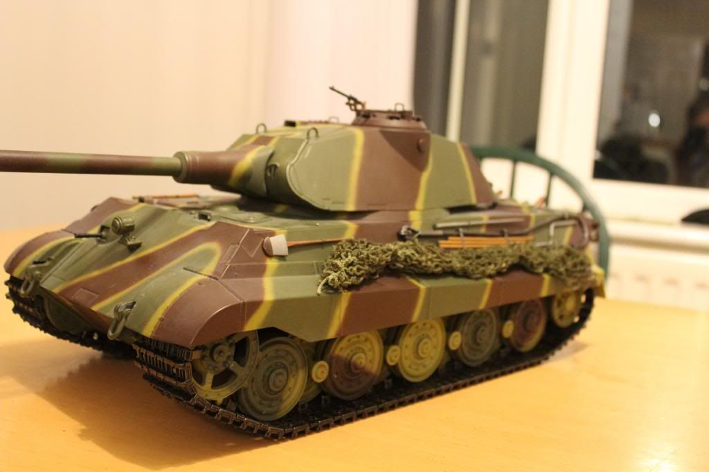

Minus fitting the TK-22 board, the beast is finished!
The wiring issue is sorted and the tracks are running perfectly.
Been a long but enjoyable project. Once a metal hull for the Panzer 4 comes out, I'll do it all again
The camo nets were made from an old net shopping bag I found. Sprayed them up and job is a goodun

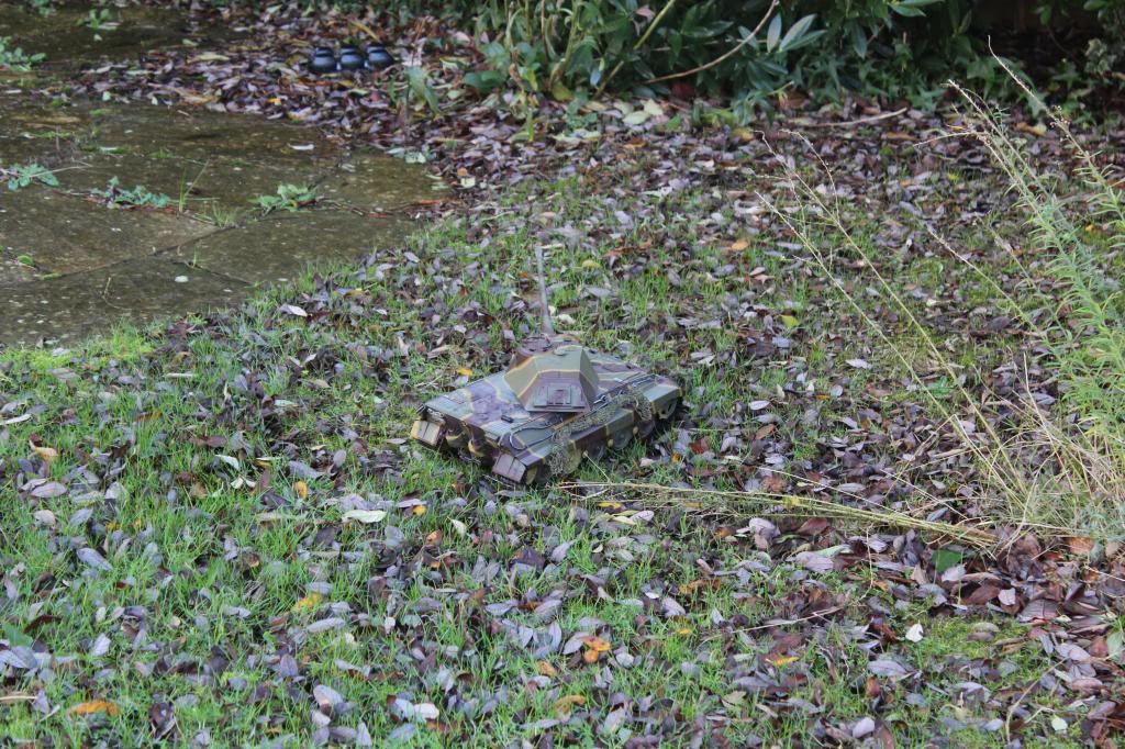

Re: Taigen King Tiger rebuild
where is your tank? your last pic just show heaps of grass n fallen leaves. Can't see a tank.
