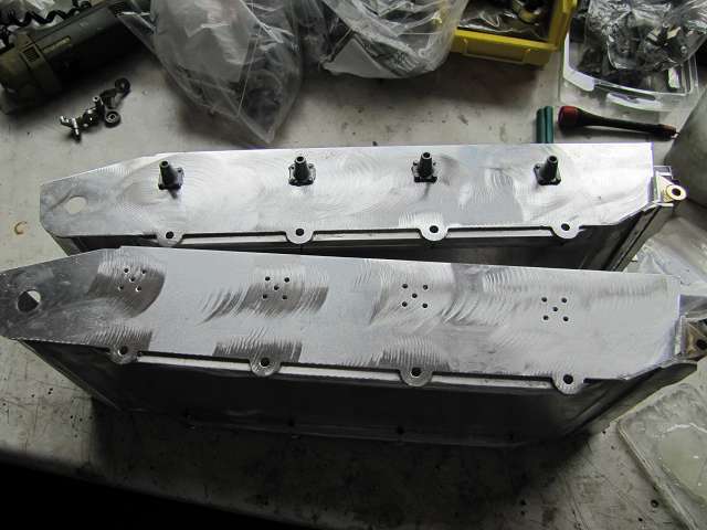

The second tray gets its stern struts.
Now after the adhesive had cured, I could make the holes for the recording of the roller carriage.
Unlike HL I do not use a screw axis, but the terminal 4mm axles with a small setscrew in the tub.
Then I have done with the cam roller runner blocks further and closed the spring mount in the first step.

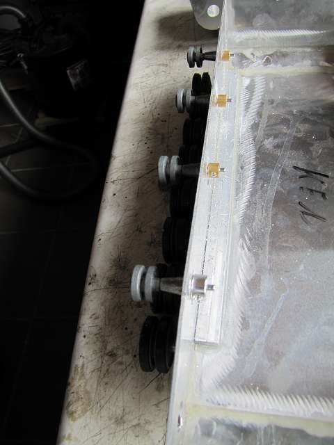

Now I can start the drive.
For this purpose, I first drilled on the sides of the predrilled holes for the supporting role holder and glued them.
Next, I'm the 16 axes for mounting the roller trolleys from 4mm silver steel. This plan, I turn to one side and solder a washer as a stop biting.
After brazing, I turn the slices on an appropriate measure and verrunde them something. So then they fit perfectly with the cam roller runner.
I have revised the suspension at each side of the drive and joined together to conclude for today. In conjunction with the stable control of the axes of the tub and the softer suspension this works later as they should and not just wobbles a bit with the cam roller runner.
As it stands now, I might next week then with the two wells are completed as far as being able to drive around them.
