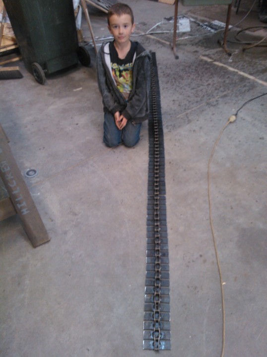

Have started welding the plates onto the chain and got one complet today
one more to do
My assistant/co driver/gunner sitting next to the first track
Track rolled up ready for storage till needed.

WOW!
