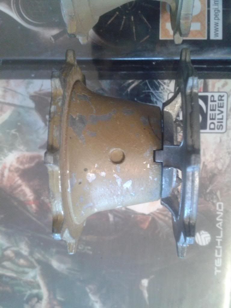

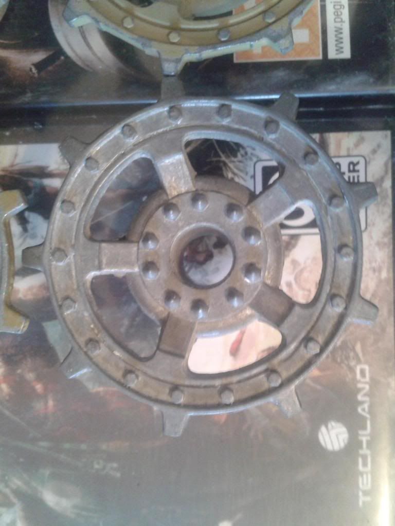

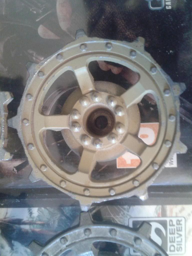

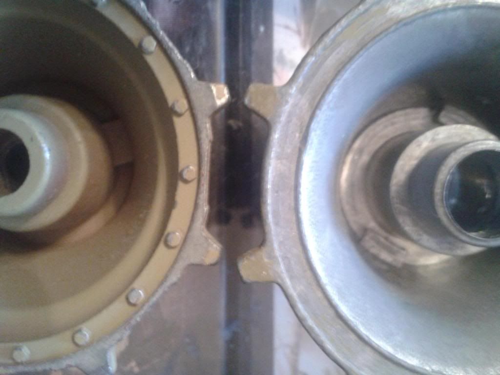

Apologies for the following, it is however necessary... First are the pictures of what I believe to be the older type which I AM using. Note that they've been drilled out to 10mm in order to be used in my project... The second images are what I think are a newer replacement for the first part shown. I have six of each but want to trade the six on the right for six more of the one on the left!
First the face of the sprocket. See how the older one has smaller bolt heads further apart. Spokes are also wider and the hub has a larger diameter than the new part. Finally and most distinctively are the small protrusions that each tooth sits on in the NEW part. There'll be an image to better show that later though as I found it hard to capture...

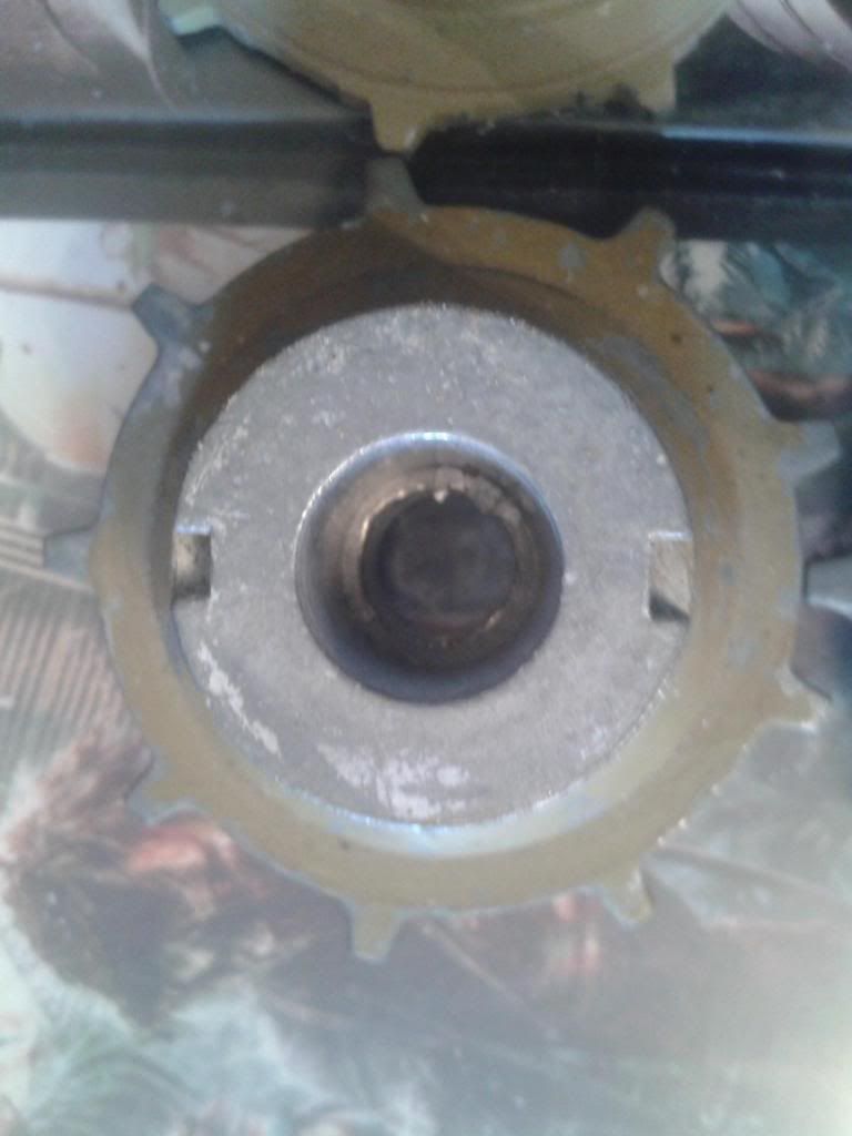

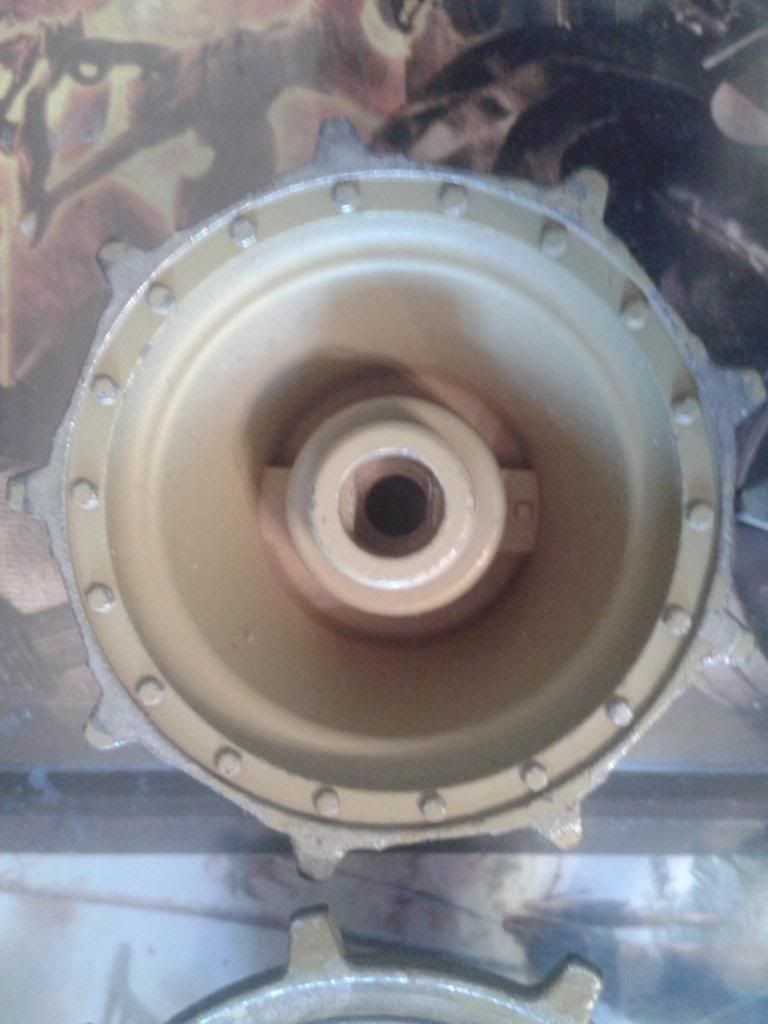

The rear of this outer part has an obvious difference but this is what I need to check with sellers before I buy as I'm worried they won't be the same as mine and noone shows pictures of them dismantled! The one with rectangular tabs is the old part I need while the round pegs are the new part which I don't...

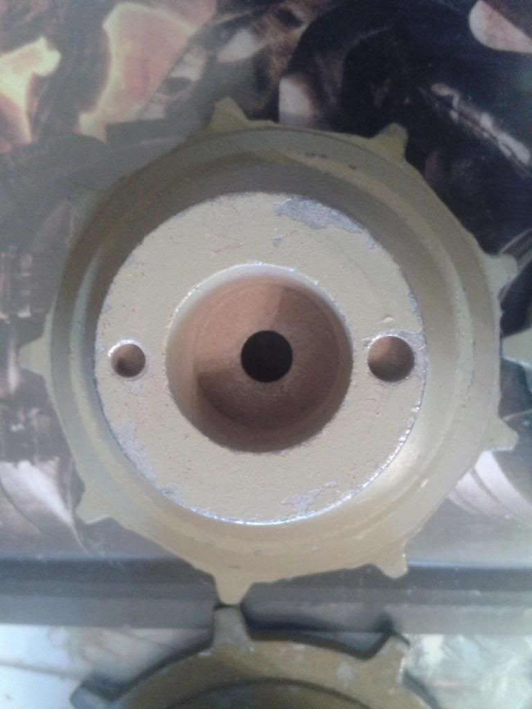

The old inner piece is about 4-5mm taller than the new one and of course has rectangular slots in place of round holes in new ones... The old piece also has a steeper and narrower body while the new piece is somewhat fatter all the way down. The new part also has a sort of dinner-plate lip at the bottom almost the full width of the piece while the old part has about 4mm of space inside the teeth.

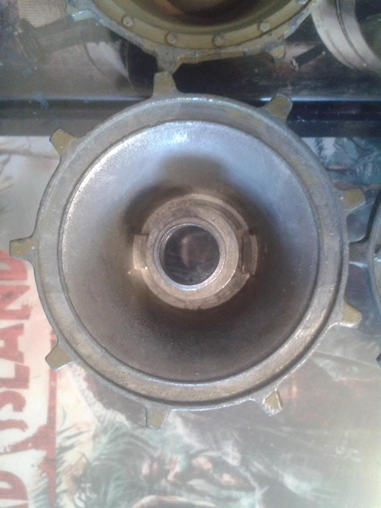

Here's the underside of both pieces... Though you can't tell on the one I already drilled out, checking an older photo I took reveals that both of these have two flat spots for axle location which apparently is very Tamiya... The older part has a very straight and angular central shaft here wheras the newer item is much smoother. The new part also has the added detail of a ring of bolts as shown here.

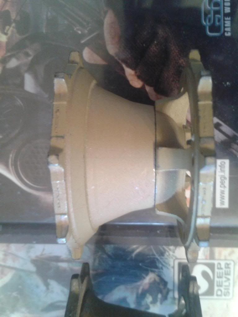

And almost forgot to put up the side views, something else that I really wish vendors would add to their shop listings! Here you can see how much longer and narrower the bulk of this older part is compared to the tubby little new one. Also how much deeper the spokes are on the new part.
The final shot I took is intended to highlight the unique feature of the newer part. If a sprocket looks like this I DO NOT want it! This hopefully shows how the older item is simply a circular rim with teeth on it while the newer one has the teeth protruding from small raised pieces of rim. Hard to explain so hopefully the image does a better job than me... It seems I took this picture backwards so it's the new part on the left and old on the right here...

Okay, I have gone through as many of the Tamiya King Tiger instruction sheets as I have been able to find, and have the answer for you. The sprocket that you refer to as "older" (has the square engagement lugs and no detail on the rear rim), came out with the first releases in 1982, and was used on the Henshel turret kits and on the first Porsche turret kits. Sometime after 2004, Tamiya changed the design into what you trefer to as the "newer" one. All kits (both turret types) received this sprocket, which had bolt detail on the back, and round engagement lugs. The reason that the sprocket teeth sit atop a raised area, was to more-closely approximate the machined-off sprocket teeth that were a change from the original 18-tooth sprockets on the real thing.
So, if you're trying to get ahold of more of the "older" type of sprocket, I would think that anyone having a King Tiger kit, (that they bought around 2005 or before), would be very willing to trade you for the "newer" type, as it is a more-accurate sprocket for their King Tiger. -Mike
