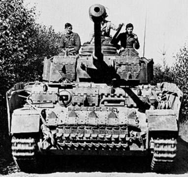

Tracks were used a lot as extra armour..... these are 2 of my favourite photos, with most of the tank being given some extra protection...
