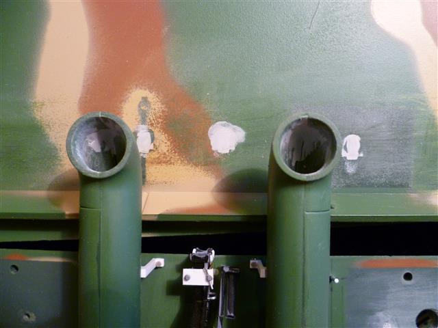

I wasn't to keen on the joints inside the exhaust showing so they were filled and sanded down.

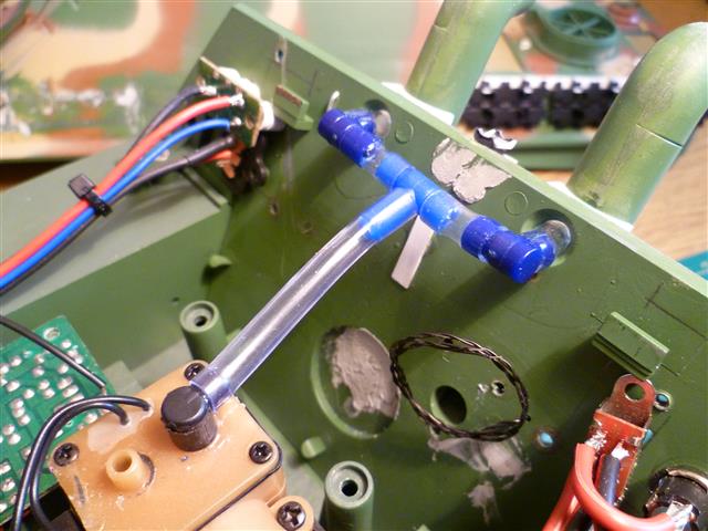

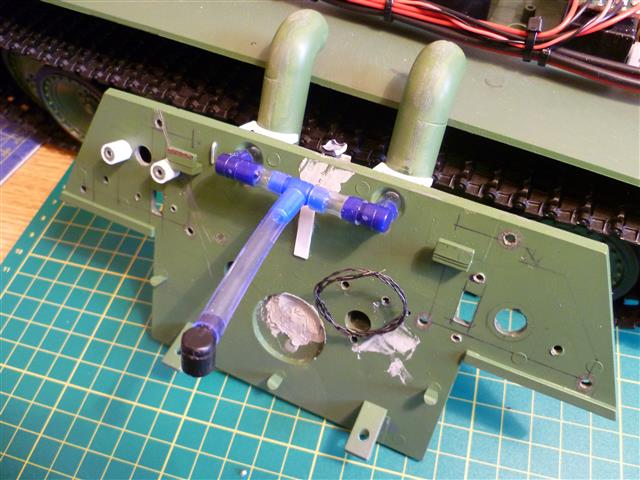

While out in a local pet store I came across some pipe in the fish tank section which is the same diameter as the smoke generator attachments,so ..................................The other hole on the smoke generator will be used to fill it with oil through another pipe that will be located in the rear stowage box if I can fit it in.The idea is to use a syringe with a pipe on it that will reach down the fill pipe into the generator.

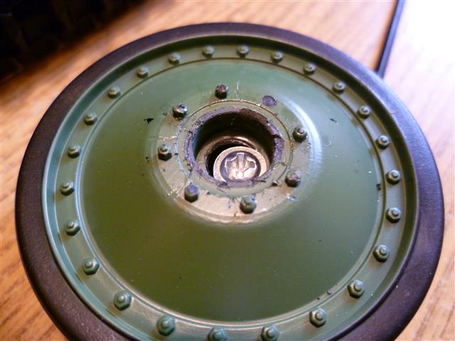

I also upgraded the suspension to stronger springs which went well until the Heng Long glue monkey struck !!!! :thumbdown:
Not pretty to look at but I will be upgrading the road wheels in the future so till then It will have to do.

Thanks Painless Wolf, the filling pipe is an idea I hope to fit on all my tanks.The syringe will be fitted with a collar so the pipe will only go into the fill hole the right depth and not enter the smoker too far and damage the heater element.While it's not been run for long ( a couple of minutes ) the single pipe does give a decent amount of smoke from the proportional smoker.
