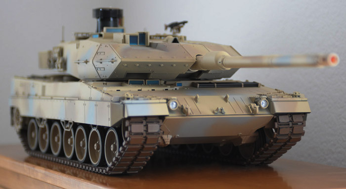

If you do not need or want all the rc bells and whistles, a Futaba 2.4 radio will operate just the basic features. I know I have set my Leo up both ways and opted for the Futaba FM set over the 2.4 Futuba.
Solution, I use a Futaba FM ground radio for my Danish Army ISAF Forces Afghan-Desert-Leopard.
John
Danish Army ISAF-Afghan-Desert-Leopard
