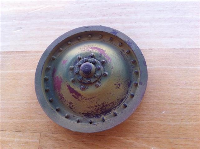

Here are some pics of my sprocket wheel.
Base color with some color modulation and Tamiya Clear coat.
Chipping, weathering and Oil wash complete.
On my sprockets, I don't paint the silver effect of where the guide teeth would be roughed up. I don't believe paint would represent it properly, I'll let wear and tear take care of that.

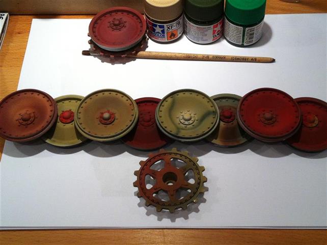

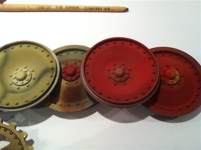

Re: Panzer Road Wheels....PAINTING
I love to have some 'primer red' parts on my tank. So here is a prev of what I'm working on right now.
- IMG_0477 (Medium) (Small).JPG (45.6 KiB) Viewed 2968 times
- IMG_0469 (Medium) (Small).JPG (37.84 KiB) Viewed 2968 times
- IMG_0468 (Medium) (Small).JPG (48.11 KiB) Viewed 2968 times
There we go, great looking set there Max.
Thanks red devil.
this is just a teaser, I have a video and some more pic's comming up in my JP build soon. I'm awaiting some ak produckt's any day now . They need a wash and some oil and dust.
Eastern Front. I got it covered my friend
Ak pigments on it's way for that shiny inner road wear
