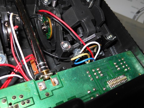

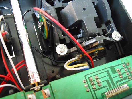

Okay here you go. The pics from mine. When I try to take the glue off the yellow one came off too so I have to remember this is a non-working one now !

Thank you very much for the pictures! :clap:
It's really hard to see where it is supposed to be attached though. :|

odd, your loose black wire should be connected to the same spot as the blue wire. I just opened mine up again and took out the stick to confirm.

I tried attaching it where you suggested without much luck. I'm breaking down and buying a new controller so I don't have to deal with it anymore. :haha: :crazy:
