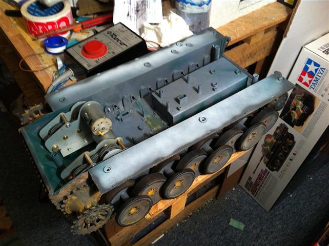

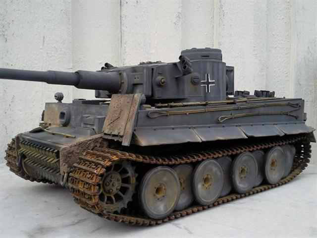

Thanks for the info, and this tread. I have a rolling tiger that needs most of the electronic's. Not sure I would spend el-mod cash on it, but it seems to give the best performance 'out there'.

hey Max your Tiger looks great!
