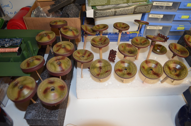

Well I have been a bit busy as you will see. I have painted the wheels, first sprayed and then hand painted then.

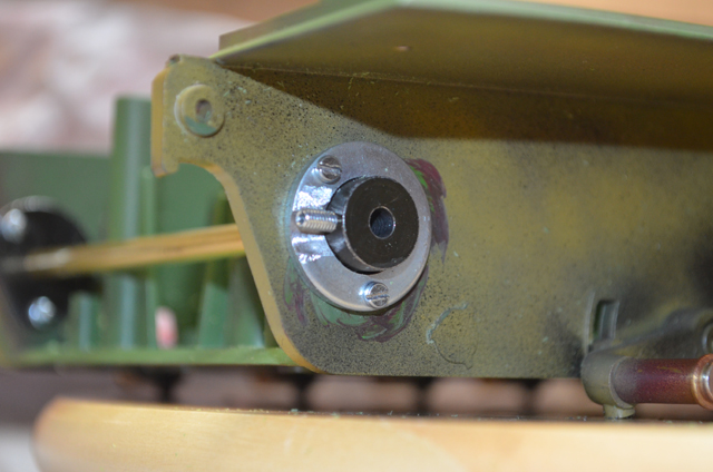

I was going to use the plastic track but I got hold of some metal track off "Forgebear" on ebay so I had a change of mind. I already had motors with metal gears and also rear Idler wheels fitted with bearings, so I decided to try fitting a track tensioner kit as well.
First was the track tensioner. As I say before the idler wheels had bearings fitted and as sod law prevails the stub axles were a bit too thin and long for the tensioner kit. I decided to use a bit of brass tubing cut just proud of the wheel axle housing assembly. As luck would have it the brass tubing was perfect for the wheel axle housing assembly, but the inner diameter of the tubing was too small for the stub axle. My solution was to attach a round needle file to my hard working dremel to enlarge the inner diameter and it worked. All I did then was to cut down the stub axle.
That done I removed the plastic idler wheel holder from the lower hull and sanded smooth. You need a 13mm drill bit to enlarge one of the holes required to fit the main tensioner assembly. Once the hole is drilled I temporary fitted the kit to mark the holes for the two small nut and bolts. I also filed down part of outer washer for better access to the allen grub screw.
Now I fitted it all together. I filed down the brass tubing connecting the two idler wheels where they touched the two plastic hull supports for a better fit.
