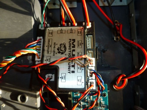

Hi Guys,
The supplier sent me a new RX18 board to try before sending the whole thing back. So I opened it up and had a look. On closer inspection of the wiring i found this (I untwisted them as the bare wires were touching each other), looks like quality control was on holiday when my tank was made. I tried the new RX18, and got the same result as before. So I'm now waiting for the courier to pick it up right now.
Tony

thats just the track recoil switch wire,and would not work or if shorting would be stuck in recoil, think it will be the receiver board as they are very doggy i have 7 failed boards with that sort of symptoms,but i do do a lot of tanks so i will see more faults.regards

Heard from the suppliers this morning, it seems that the battery charger is faulty.
