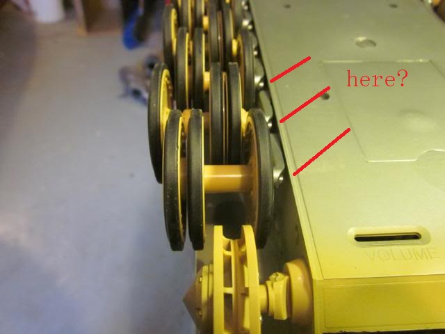

I am pretty sure they are screwed in from the rear, I took some photos of one as I took it apart...Since I am not using the lower hull, I dud not pull the wheels....look here, see tne notches in the arms?

Thanks for your photo. can you label your photo so I can understand clearly. I drilled the front of the wheel and found there is some type of metal axle inside. However, I am not able to take it out as the plastic is really week.

not at workl....they do not unscrew from the front, they unscrew from the underside of the tank look at the back of the wheels, not the front.

Hello,
I just labelled your photo and am not sure is that correct.
