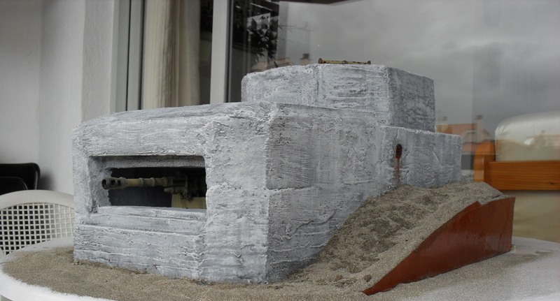

For the D-Day anniversary, I made a bunker equiped with a 105mm gun. The gun is coming from a toy with some modification it will work well init, to allow the gun to move left-right, up-down and some vibration when firing, I used few components from a Heng Long 1/30º tank.
The bunker it self is made from foam then I puted some filer. On the side you can found the on/off switch and the plug for the battery charger hiden behind some green.

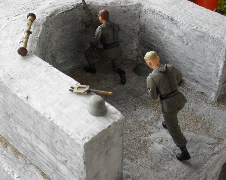

On the top of the bunker,I planed a Flak 43 gun to take place but unfortunatly it don't arrived on time. So to replace the A-A gun I placed MG gunner team. About the uniforms, for the feeling of surprise I don't put all the items on it.

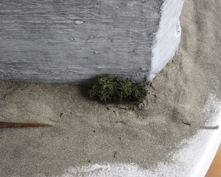

Hi, OdysseySlipways
I used a book: Bunker Archéologie of Paul Virilio for the photos and drawing.
I used Grey Cement upon medical netfor the side.
One's dry, made a wash and then a light dry brush andthis is it!
I hope I've answer to your question.
