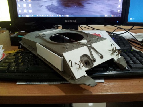

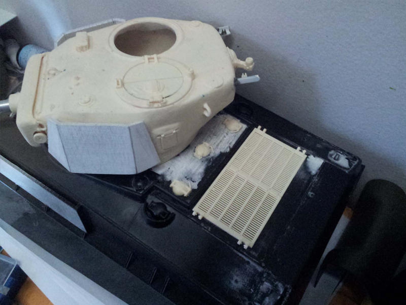

I'm working on a conversion for the original Tamiya Sherman to M4A3E8 "Easy Eight". Below I send the photos of the progress so far. I have a question: does anyone know how to make the barrelrecoil with servo?

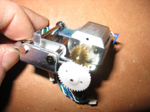

I am sorry but I do not know how to make the barrel recoil on a servo motor.This strikes me as a harder conversion. I presume that you are using a standard remote control unit, rather than Tamiya or Heng Long. A standard servo would require a signal to be sent to make it move in one direction and then a second opposite signal to return the servo ( and the barrel ) to the start point. This would require very accurate and precise actions from the operator....BUT Heng Long make a specific recoil unit that can be attached to the barrel and of course Tamiya make a recoil unit which is probably smaller than some servos.Both of these unit only require a momentary supply of power because all the actual movement is controlled by a separate circuit with a limit switch so that one 'pulse' of power equals one recoil action of the gun. I have attached 2 photos so that you can see the Tamiya unit.
