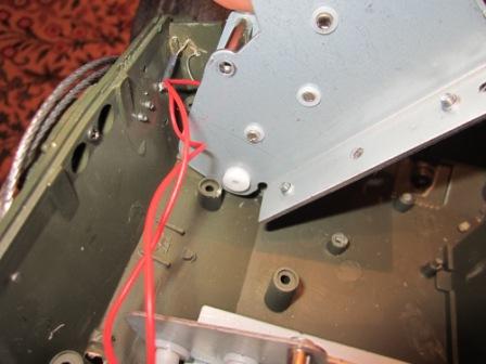

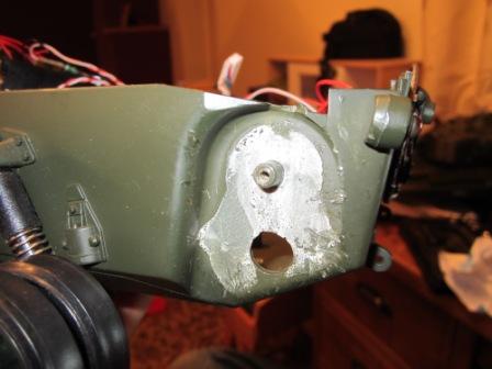

I had wondered what that plastic case is for, as despite taking the screw out I couldn't shift it for love nor money. I wondered if our friends at HL were being liberal with the glue, so with extra force and large disregard to the tank I've managed to force it off 8O, and lo and behold, more super glue than you could shake a stick at! Still, at least I can now put new boxes in :D . For anyone who's not yet tried taking out a HL Pershing box, here are some pictures of the problem.
Lots of glue holding this cover on
Lug for smoker screw getting in the way
