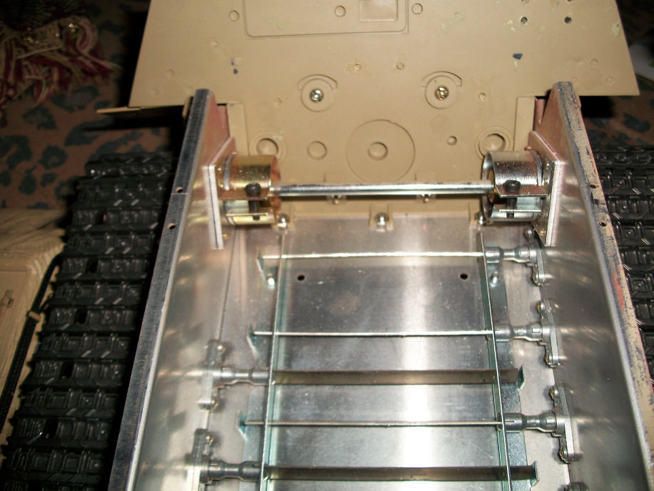

Below are the Tamiya King Tiger Track adjustment system,loosen the clamp bolts pull back on the tensioner arm/wheels and tighten the clamp bolts.
