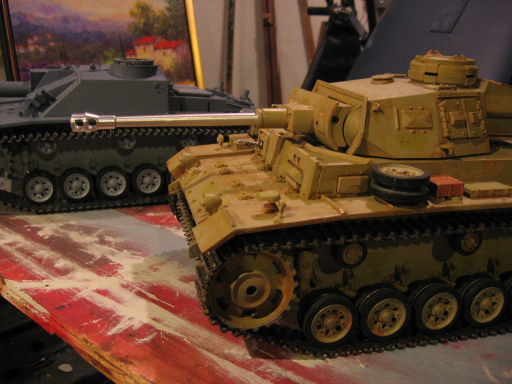

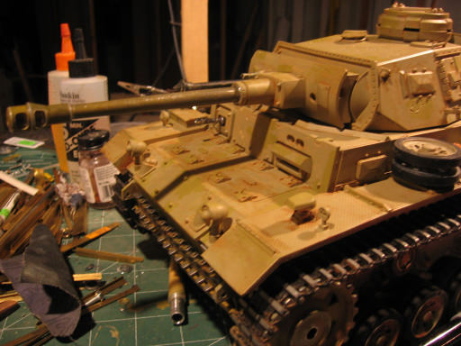

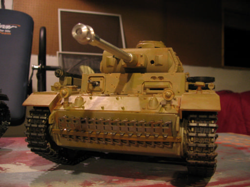

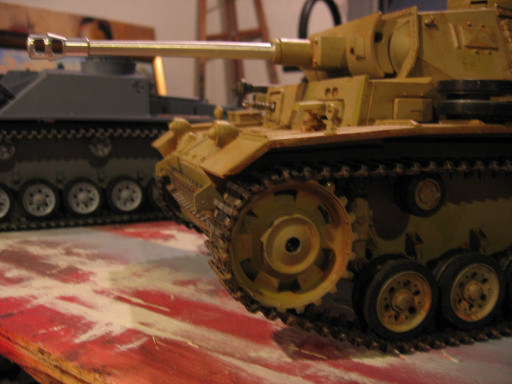

Re: Panzer III Heng long Asiatam rebuild:
The KwK 40 was a very versitile cannon. Used on the PIV as the KwK 40 L/48, I plan to try the KwK 40 L/43 caliber length for the PIII. For this experimental version I chose the same gun made by ?Modellbau (I had a spare) and it fits perfectly into the 75mm BB housing on the PIII HL turret. Barrell comes with aluminum sleeve which is pushed in from rear and creates nice snug fit to barrell.
Although I can;t find documentation on this particular gun fitted to a PIII, I do have a picture of a PIII with the long 50mm cannon with muzzel break (~1943?). So if I say this is a slightly out of scale 50mm cannon, this could be a legit model.
Anyway..looks good. would not want to load it in the hot sun..
Enjoy some pics:
Enjoy some pics:

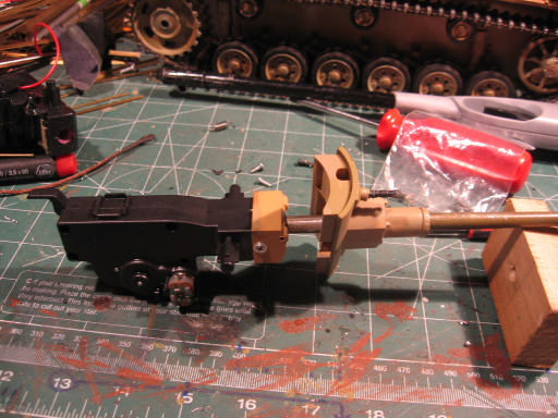

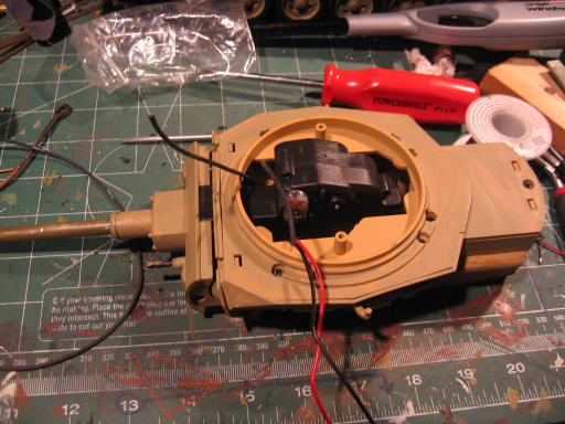

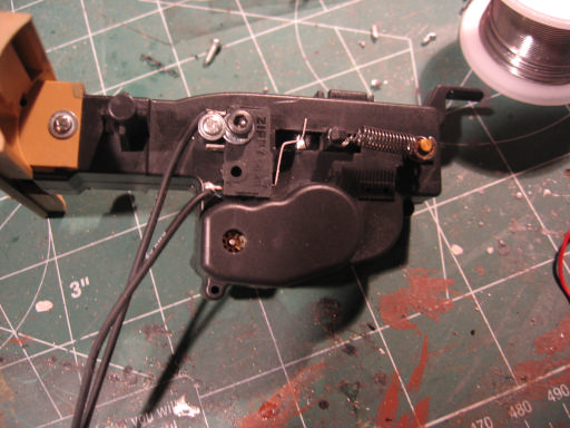

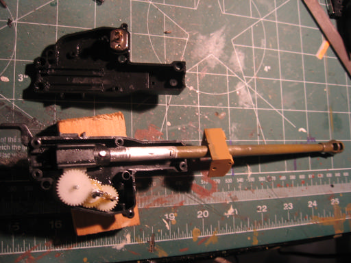

Recoil mod done even better this time with brass rod and E clips.
Be sure all the parts are on the barrel BEFORE soldering the retaining pins....(because the muzzle break does not come off)
I used an aluminum tube (hobby shop) for barrel extension. The aftermarket barrel fit the tube perfectly and is held in place with brass pins (pics). barrel not long enought to fit recoil unit. Aftermarket barrel in green and aluminum extension in aluminum color. Make sure nothing rubs. place pins like I did so they don;t interfere with surrounding stuff. Pins also ground down.
micro switch with extra safety screw in place. almost ready to test.
No flash this time, barrel diameter too small. No LED either...too lazy.
