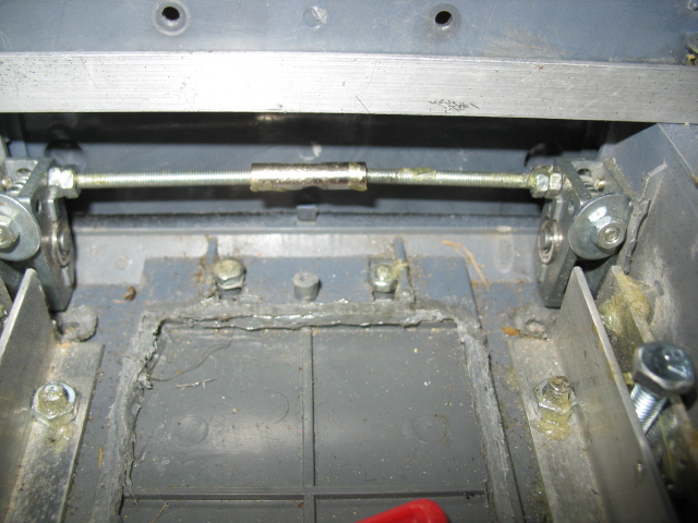

Step Four:
This plastic inside the hull needs to be completely removed.
Step Five:
I removed the bulk of it with a hacksaw blade.
Step Six:
This looked truly awful to start with but after some Dremel-action it looked much better - though I'm sure someone with steadier hands could make something many orders of magnitude neater.

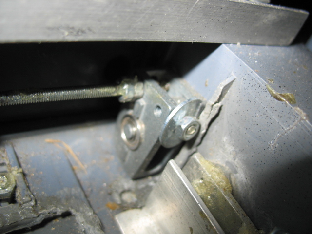

Step Seven:
Use the included guide to place the two screw holes necessary for mounting the idler support. I used a 2mm bit to drill a pilot hole through the guide, then drilled that out with a 3mm bit.

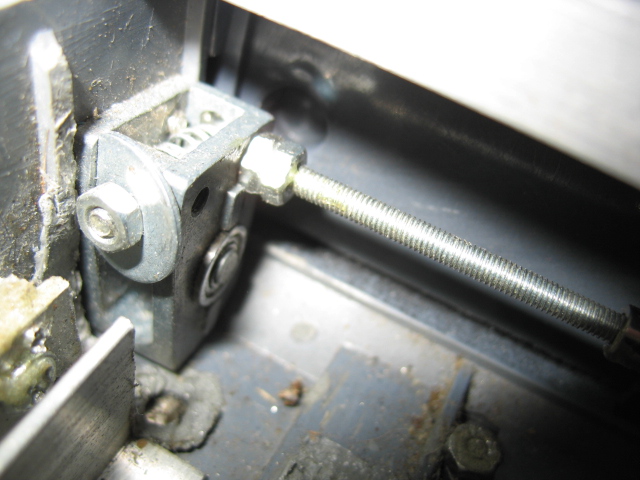

Step Eight:
With these mounting holes drilled and the interior of the hull completed and sanded the mounting block can simply be screwed in to place. The blocks are not identical so make sure you fit the right one to the correct side of the hull.
Step Nine:
With the idler block screwed in to position it should look like this from the outside.
Step Ten:
Line up the interior bearing so you can fit the shaft that will support the idler. An allen screw will lock this shaft in to place. The dark-coloured shaft included with the set is used to actually fit the idler, which is pretty self-explanatory.
