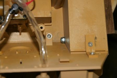

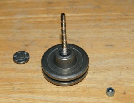

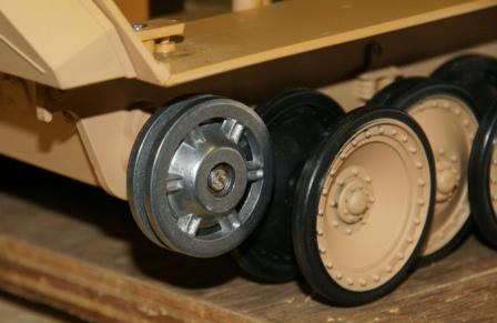

Re: Metal Idler Replacement
Hello
I have put the idlers on. I drilled a 4mm hole into the hull and bolted the idler using a nut on the inside of the hull.
It works, but will replace with a set of tension adjustors soon.
Tanksparky
Tanksparky
