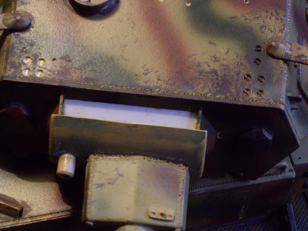

These next few pics show the odd few sunken screw holes added ,screws made from thin slices of plastic rod ,and chopped in half and then popped into hole spot of glue sorted ,....also added the screws too the second splash guard in the same way,only this time i used .o7mm hex rod for the bolts ,.............and then added the missing screws that will show even when the turret is turned,this simply by just drilling with a1.5mm bit to just scratch the surface,.......all the other holes that are there but can not be seen ,did not add..........
