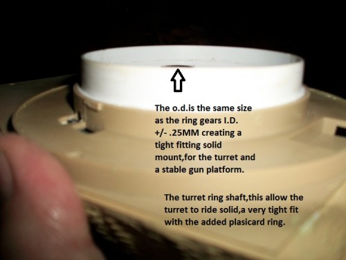

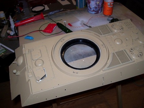

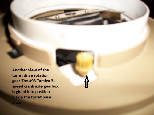

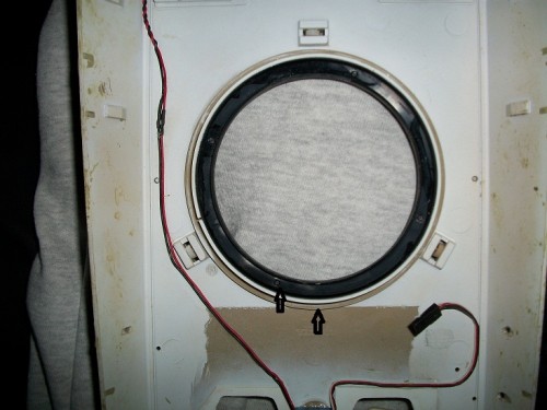

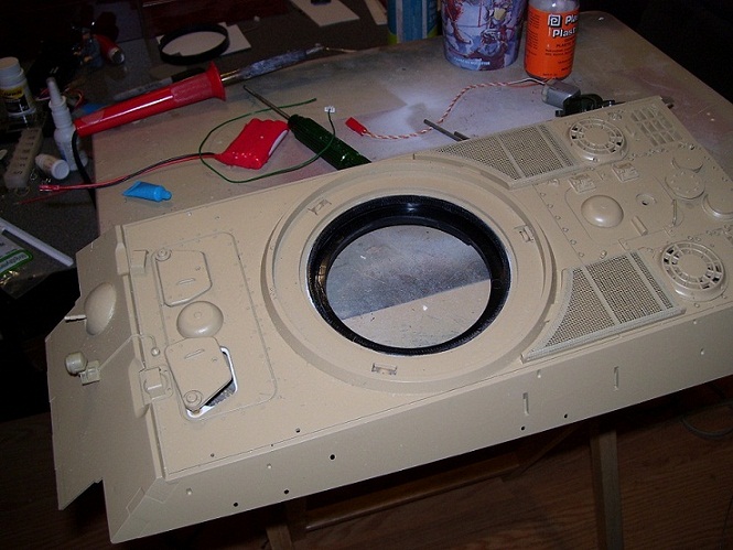

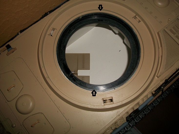

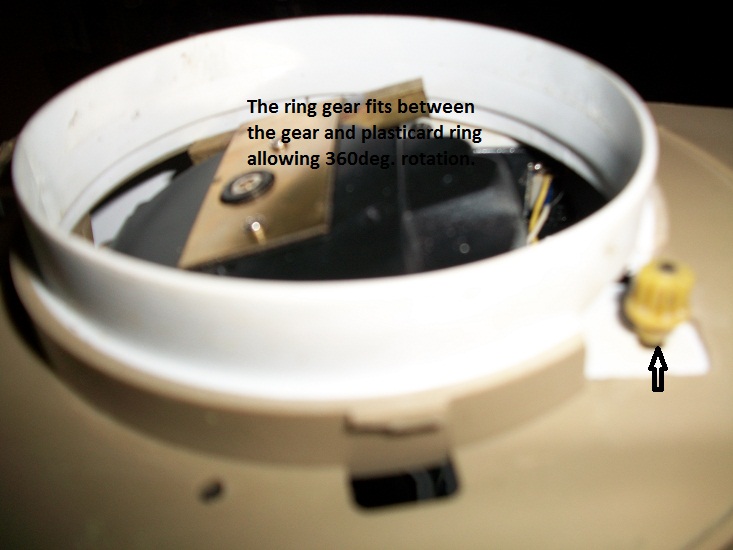

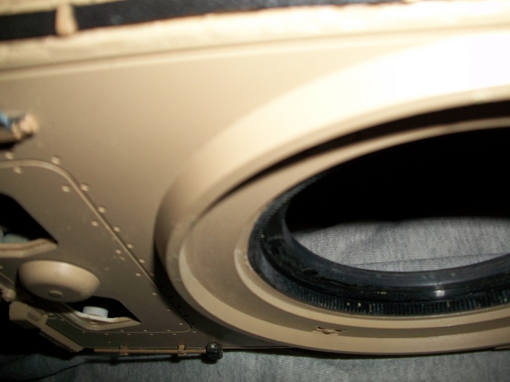

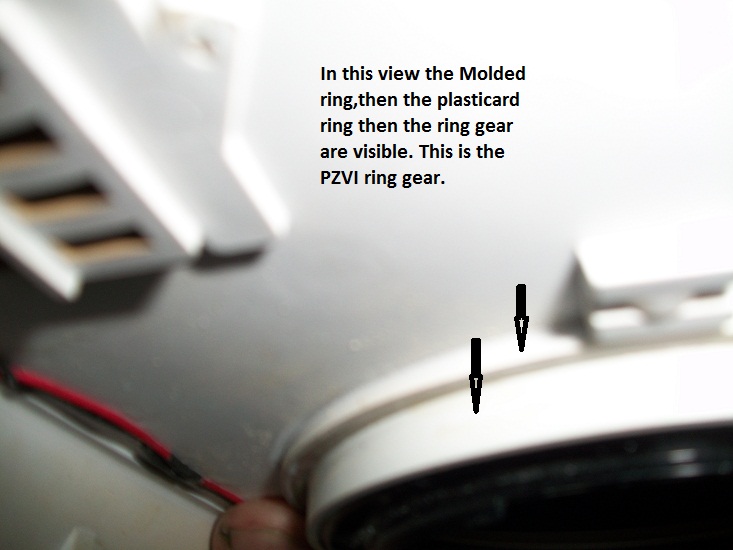

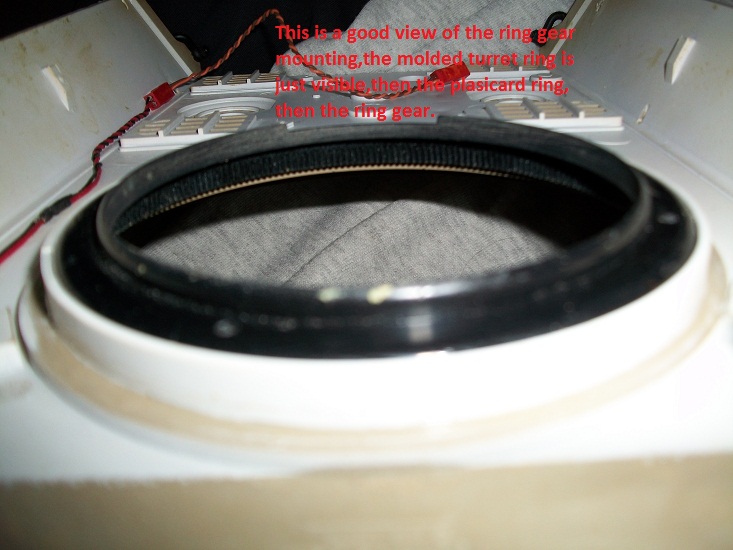

Their may be a better way, the ring gear modification which allows the turret to rotate 360 and be removed simply by lifing it off the lower hull has been around for a while. Look at the pictures below.

This modification was shown to me by Bubbajoexx, I purchased three tanks from him last year ans each had a version of this turret ring modification. The RING GEAR is from a Panzer IV the rotation gearbox is a small gearbox kit from Tamiya part#93 3-Speed Crank Axle Gearbox.
If you need some more information please ask,this mod is great for several reasons,Turret removal is very simple, complete 360deg. rotation.More compact hull and turret layout.
Sax
