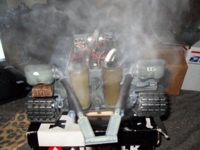

If this were available as a system that require no more space than the factory smoker uses who would want the system? Because if we can produce this cloud behind how difficult would it be to cause this effect in the front via the barrel?
Sax
Super smoker
Super smoker
Super Smoker Running 002.JPG (30.14 KiB) Viewed 745 times
