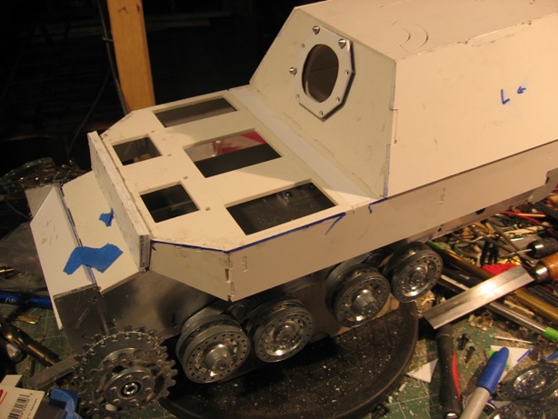

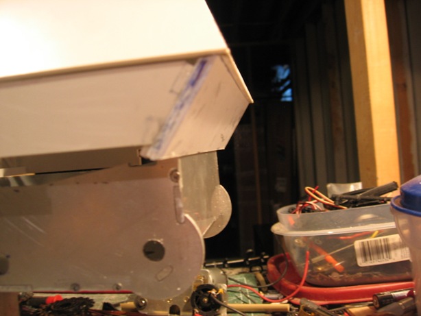

Some more work on the elefant. needed to trim 4.5mm off plastic hull length(blue line on sides) to get front of upper hull to line up correctly on the side view. Still a little off but if I don;t tell you where, you probably won't know.
Next was beefing up the fron armour. Need to make it about 6mm thick. real easy with plastic!
Drill and place bolts on lower panel, each head clocked to match the aberdeen elefant. Next will be to trim the aluminum hull where the curved blue line is (so it looks like the hull in the picture of the fenderless elefant in italy).
coming along slowly but correctly.
