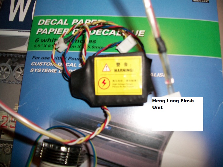

Here is a picture of Heng Long Flash unit and Tower. Sax

Hi Blake,
thats the unit I've ordered but whats the small bulb on the long red and black wire attached to the socket for the I/R Cable ? (Bulb at the bottom of the pic)
Thats the bulb that was in the barrel of my jagd :)
Pete

Thats the kill indicator bulb, when your dead it blinks. cheers Blake.. Note some guys add lights to this section of wire and wrap around the command copula. Also I have been working on a kill effect smoker bu that is another story. Hope the information helps.
