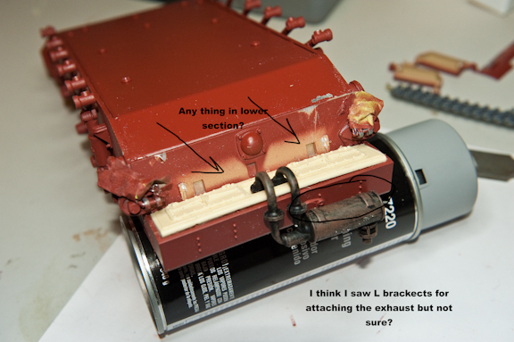

I need your help with some photos of a Stug with a fording exhaust for my build. I have a few showing it but none as to how it is attached and what the lower hull looks like if there is any changes vs. the standard exhaust. I have attached a couple of photos of what I mean. Thanks for your help. Shotgun
Hope you can read the text in the image

Follow this link, a few minutes into the video you will see the rear of the Stug, soon after their is a line drawing that shows the rear end section.The other two links are Stug three history parts 1 and 2. Hope this helps, remember to freeze frame on full screen. cheers Saxondog

Thanks Blake and JohnF, the First Video was good. Interesting with the C clamps next to the outside cupola. How fast we adapt to survive is always amazing. Will look at the rest of the videos when I get home from work tonight. Thanks for the nice photos JohnF. Shotgun

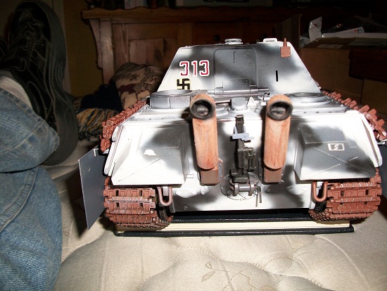

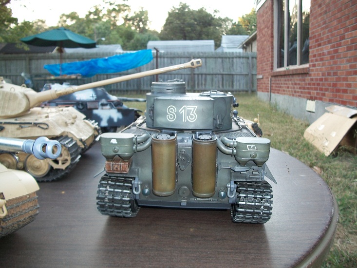

Here are a few picture of the exhaust on my Jagdpanther 313,and Tiger S13. This effect is done by first a rough sanding,then chalk pastel dust ground into the grooves, a light mist of thinner and more pastel dust. The thinner dries and bonds the dust. I have also tried this method on my Tiger S13. But on the Tiger I coated the exhaust with varnish mist. Saxondog

Good info Blake, thanks for the images, nice rust job. Thanks Shotgun
