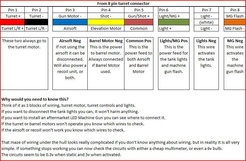

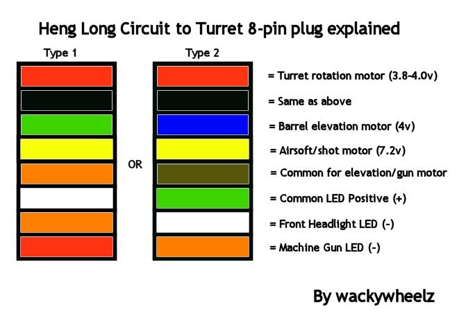

Sure John I can help, the attached drawing should describe what you need to do, if their is still a problem we can work through it , cheers Saxondog (Blake)

hi ,i am still lost ...the guns i have got are fron welsh dragon models i hope that helps any body thay have a red and blue wires..if there is a diagram showing me where to put them it would be most help full as i dont have a glue in wiring ....thanks for the help......

Ok, here is what to do, first of all you will need to open the Tank, have you done this? First step so I will stay online and we can work this out. So answer the question, then we may need to go too chat to do this mod. Blake

Great Pics Sax!

Thanks Xrad, they really do help simplify the control system. But i'm afraid the simple MG install may be a bigger job than realized. But this is the right place for advice.

i have done it now i had to change the leds as the wons that came with the guns thay did not work,but when i looked at your info thay work .so thanks for the help
