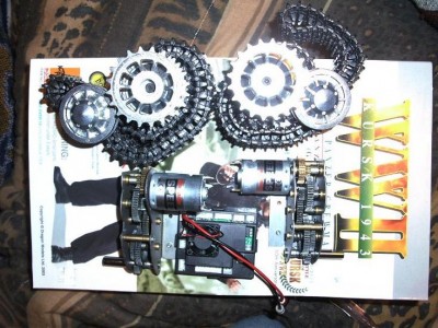

Hello Rob,I must agree with Alan,the weight and control in rough ground is much better.Otherwise with a lighter tank and plastic tracks the tank seems to spin tracks and not dig in.But also as Alan has stated the gearbox and output shafts do require an upgrade as well.Their are several package deals available so check out the vendor section for where to purchase the parts,member discounts available with select vendors.The Drive package parts in the picture were all purchased from recommended vendors listed on this forum. Blake
Asiatam 3:1 gearbox,Gruapner speed 400 race motors,Fan Cooled RX-18,Metal sprocket,Idlers and Tracks
