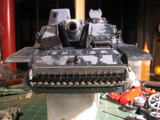

Some more pics:
want extra protection, add some track to hull front. In this case, copper wire and epoxy secure Asiatam PIII track links to through holes in bronze hull plate. PITA. looks good though...
every joint and weld and nook gets thinned testors gunmetal .
needed to add 3x3mm rounded head allen bolts and lock nuts through hull to hold rear hull wall in place (extra security for tensioners)

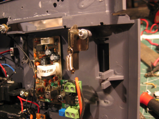

Antenna mount (top left corner of pic...threaded rod bent with x2 90 degree angles and epoxied. passes through HL antenna mount and antenna threads to it on outside. On inside, two lock nuts hold washer with antenna soldered to it. Rear asiatam mount (i only use one..it's easier to open)
