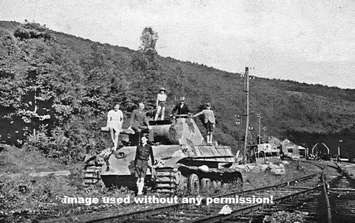

still not sure about adding zimmerit to a steel wheeld panther ? cant find any pics ???? any one help ?

Hi Found a couple of photos ,hope they help they dont seem to have zimmerit on them .
regards pete

Post by oz »
its not very clear but this panther does have zimm, whats interesting about it is the running gear' it has a mix of steel and dished panther wheels and the rear steel wheel is from a tiger 1.

Post by Plastic scouser »
Only 23 Panthers produced with all steel wheels chassis numbers 121032 - 121055 first produced on or around the 22nd of september 1944. zimmerit was stopped being applied on the 9th of september 1944.
In March/april of 1945 M.A.N produced several Panthers with a steel wheel on the last station, its not known whether this was a shortage of rubber or an attempt to reduce roadwheel failure.
Panther steel wheels were the same as those fitted to Tiger 1 and 2 except for the hub.(source panzer tracts no 5-3 Panther G by Jentz and Doyle)
I have never seen a picture of a steel wheel panther with a Chin mantlet though (waiting to be proved wrong now :D )

mcevoyi
Posts: 2294
Re: HL PANTHER G STEEL WHEELS UPDATE NEW PICS
Post by mcevoyi »
i do have a few pics of a late panther with the extra chin armour and steel wheels .. taken form a trojca book theres also a set of 11 drawings showing the the same configuration... could be wrong could be right .... but still looks good !
