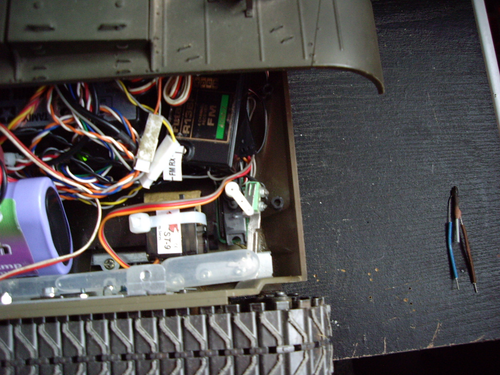

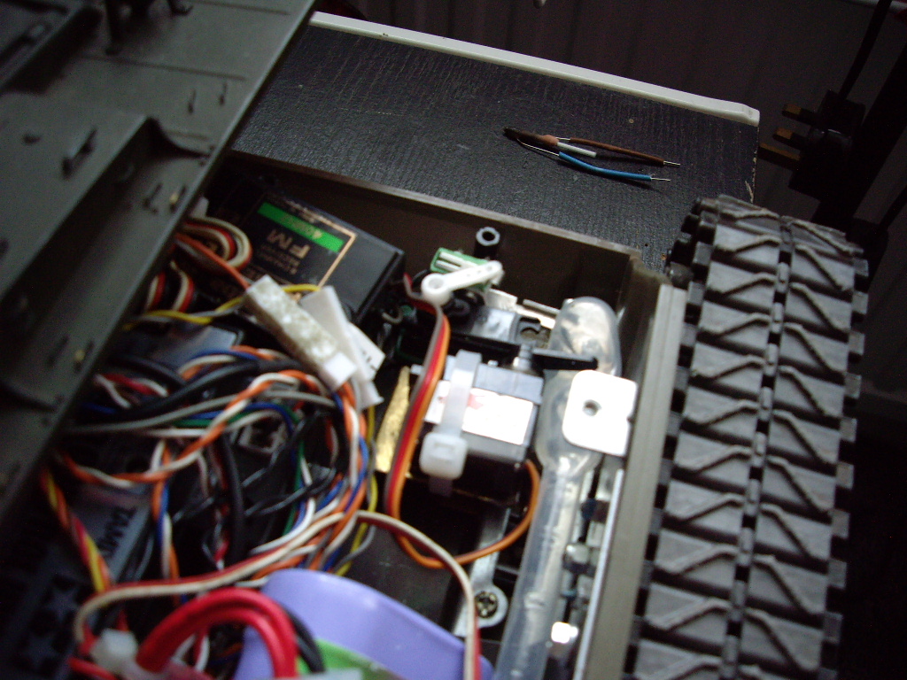

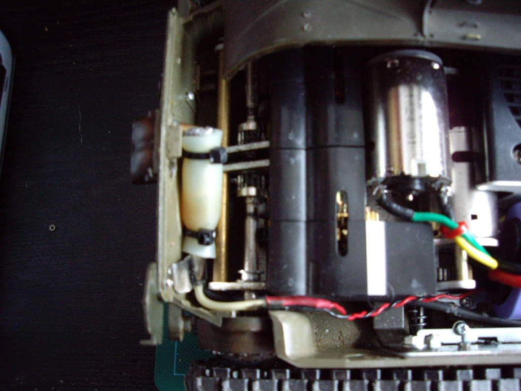

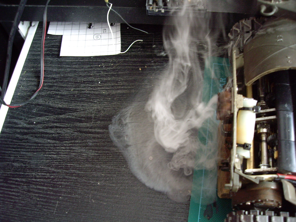

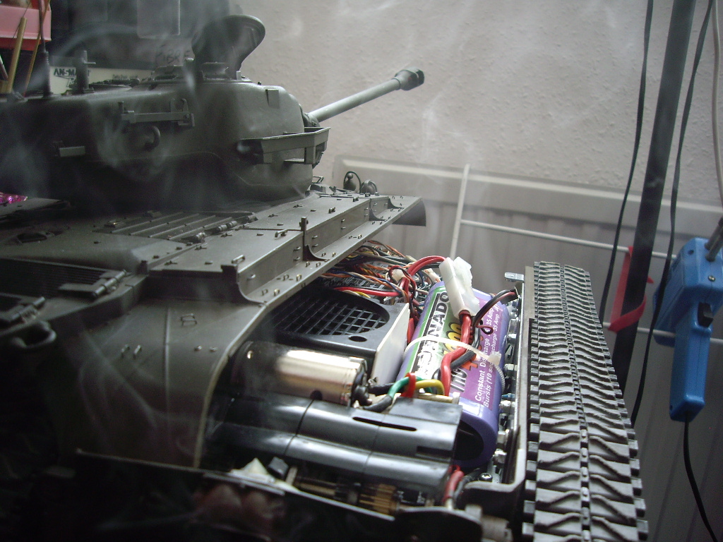

As promised a follow up on the smoker, at present uploading short vid to you tube..,,
Take smoker place near exit of model , in my case fitted in brass tubeing to tank exhaust,then fitted the tube from the smoker to a plastic pipette( the thing that you suck up liquids with)... to activate the smoker i use two miro servos,, one for the power and the other for , to press down on the bulb of the pipette ..will down load a few pics but the vid shows plenty of smoke...............

Re: Graupner Smoke Units

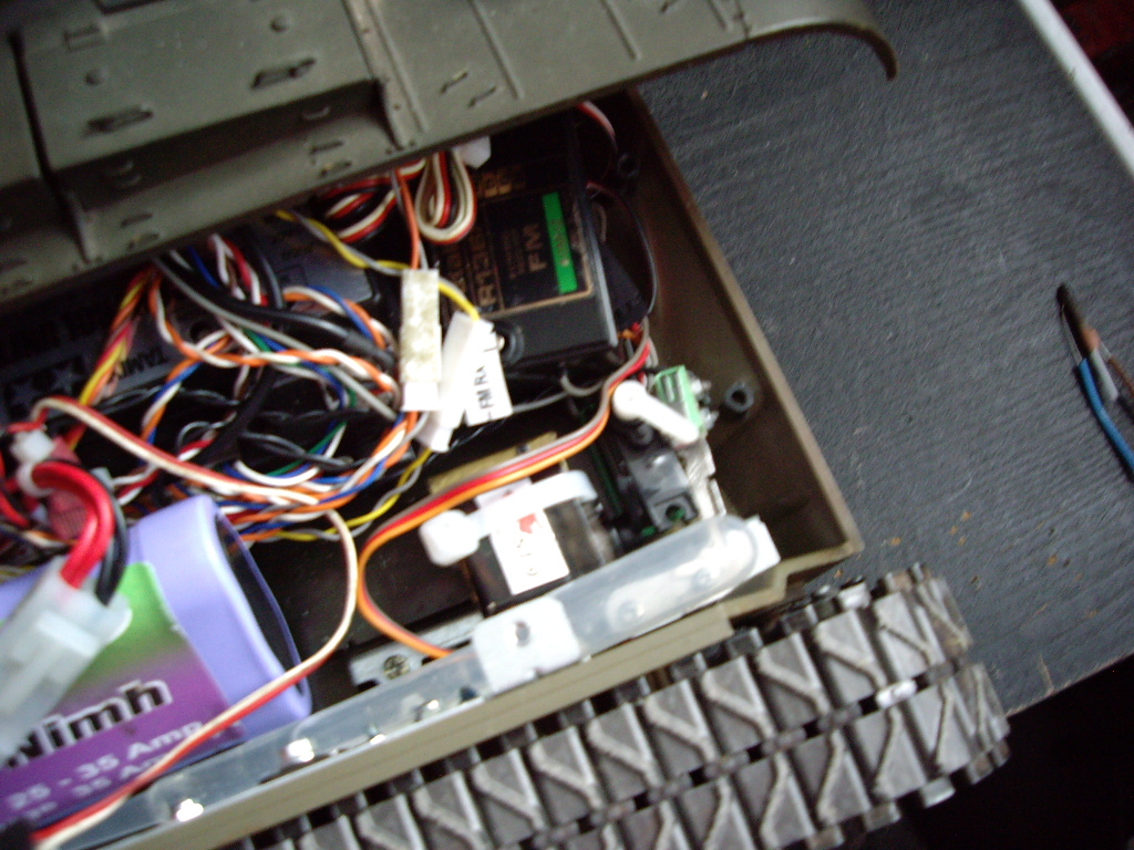

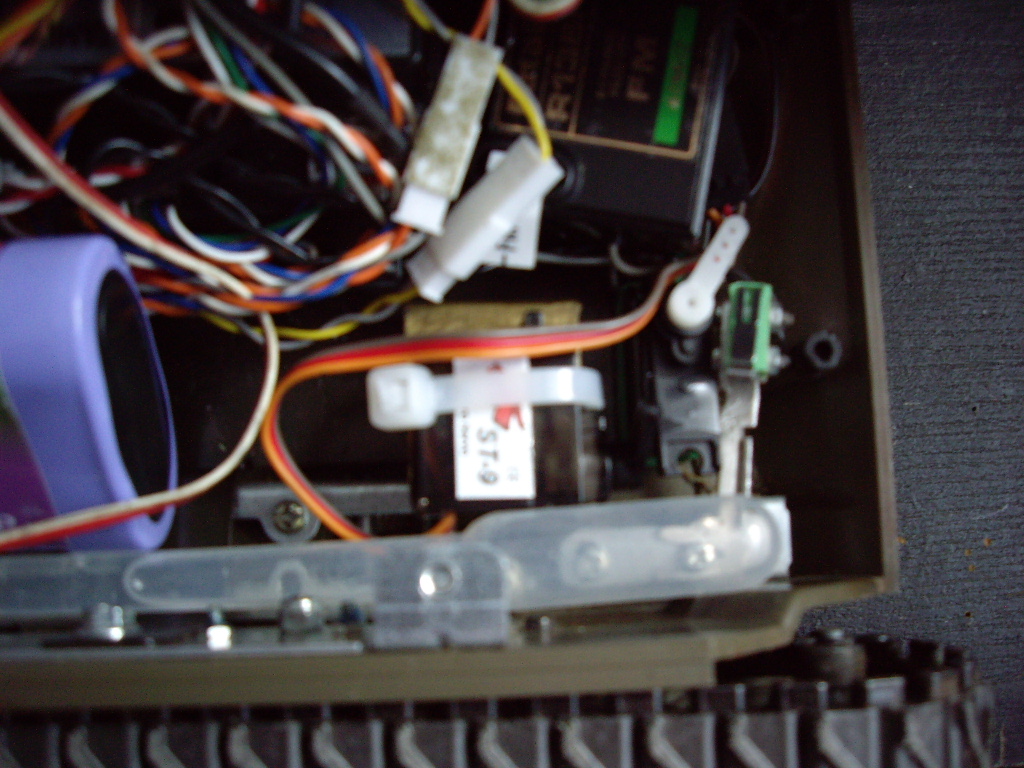

the last three pics.....
Hey man, your tank is on fire.

Excellent Fleshy! Thanks for the post and video, very informative. I did do some reading about these smoke units, and I think in my KT i'm going to try and build some sort of 'fuel tank', and then using gravity to flow to the smoker and a fan to make it proportional. I think using a tank will prevent the need to refill all the time, plus i'll have an excuse to make the fuel cap functional, lol. I'll post pics when I get round to it.
