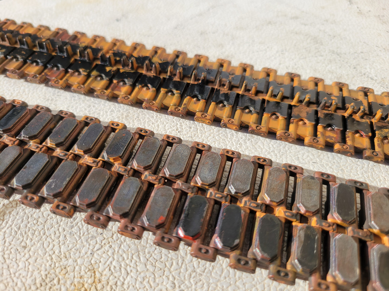

One of the things I started painting first were the tracks. Naturally I used the real thing as a painting guide, like the rusty tracks on this US Army M60:
I used Vallejo rust in several shades, along with black for the rubber track pads, and a product called "Track Wash" which i sprayed on.
I don't think I am done with the tracks though. I still have the camo "MERDC Red Desert" pattern and the searchlight to install. The searchlight will be operational, but that'll be the last step, probably.
