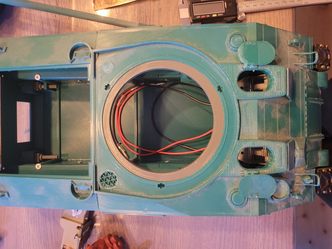

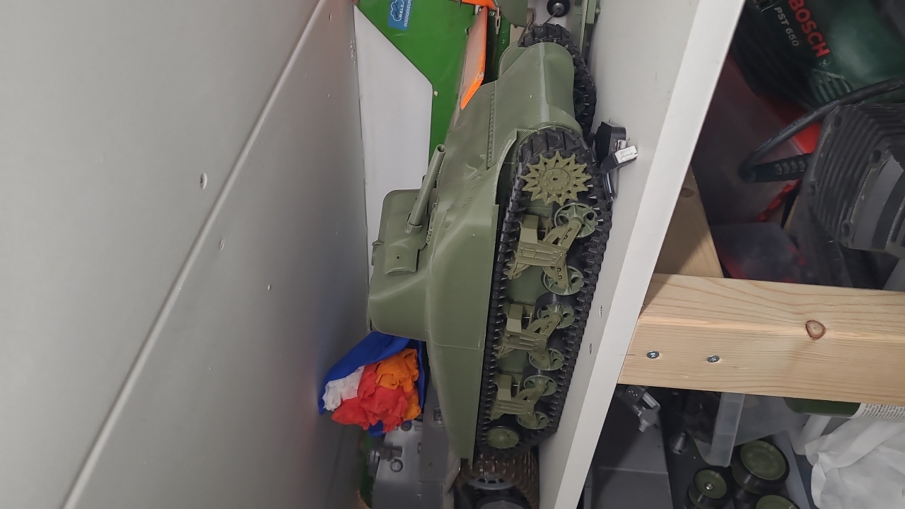

Recently I found my Firefly sitting somewhere on the shelf. It's a shame not to finish my first ever tank which I designed from scratch.
So out came the Firefly and the drawings again. Some redesigns here and there and modified to take Heng Long electronics.
The electronics are ordered and on its way.
Bogies are still my own design and work perfectly. Gearboxes, sprockets and tracks are Heng Long items as I didn't feel like building each track link myself.
Because of the longer M4A4 length, the HL tracks had to be lengthened with 6 links each and seem to fit nicely.

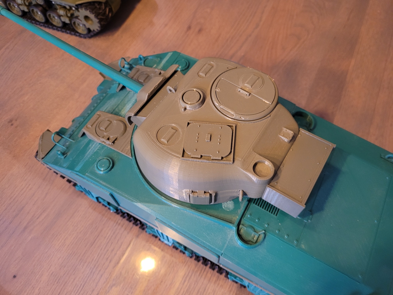

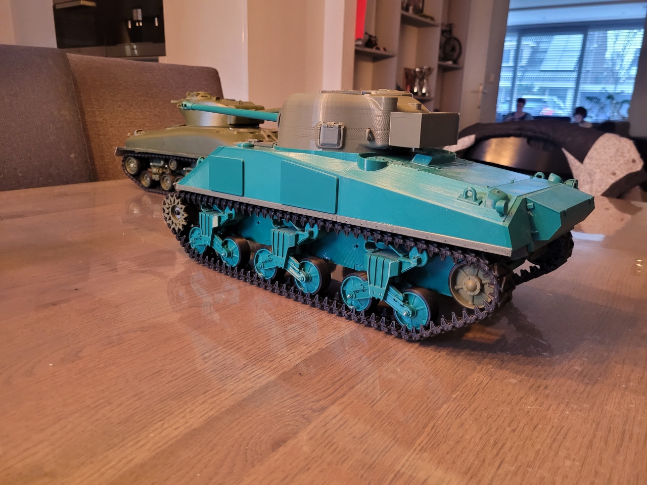

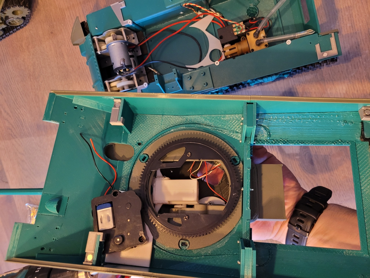

Herr Dr. Professor wrote: Sat Jan 10, 2026 10:27 pm RiskyR: I had not realized how long you had been quiet. It is, indeed, fine to know of your continued work. I remember the conversion to the "small hatch" M4 Sherman. I also see in the background of one of your photos a Sherman with cast hull. And apart from the big bustle (hmm... those in the UK seem to like big bustles :O ) I see a cast turret. Yes, my favorite as a teen-aged modeler: a cast hull and cast turret M4. :thumbup:
Yeah, me neither. Time flies!
The Large hatch cast hull in the pics, the M4A1(76)W HVSS is the HL lower with my 3d printed HVSS suspension, cast hull and turret. I recently converted this one to complete TK7.0 elektronics and it works pretty good. Needs some more detailing and painting, but overall pretty happy with it.
The small hatch version is still on the drawing board, I printed a chassis to use the HL bogies but that didn't work out as planned. I've still got a spare HL lower so I might use that one for the conversion.
