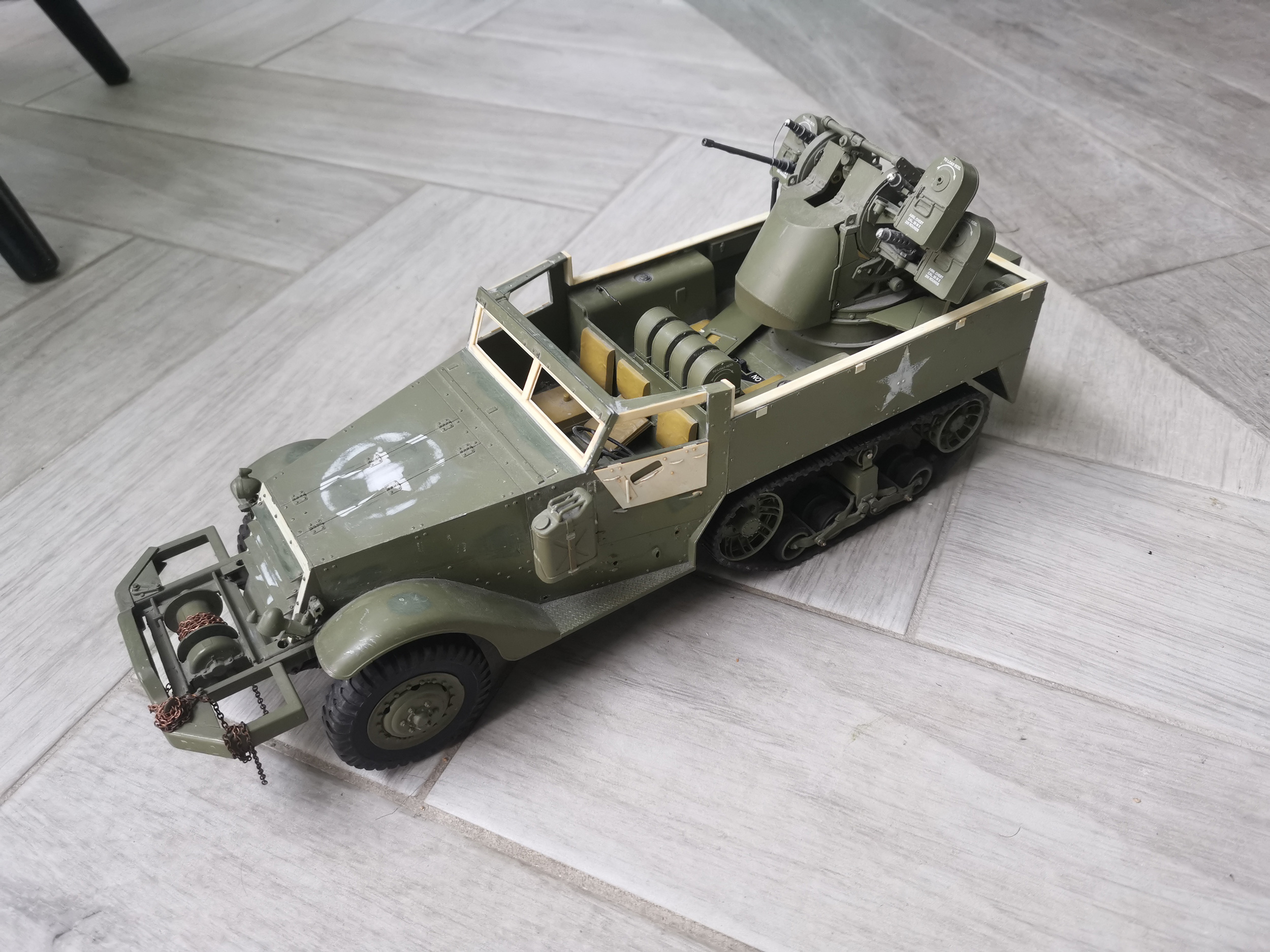

More than a decade ago I bought the Torro M16 (I think when it was released for the first time).
While the chassis and the parts while quite OK, it was a 27mhz transmitter/receiver and the operating range was quite... deceiving.
However I started to detail it. Then it was shelved... I was not into 1/16 stuff at this time.
This year one of my Christmas gift was a AHHQ M3A1 Halftrack so why not using it on top of the Torro chassis ?
Of course the plan is also to replace the old TX/RX with 2.4ghz stuff.
Well, the conversion can work but need some modification because the Torro M16 is too long or the AHHQ M3A1 is too short... Anyway it can work with some slight compromise.

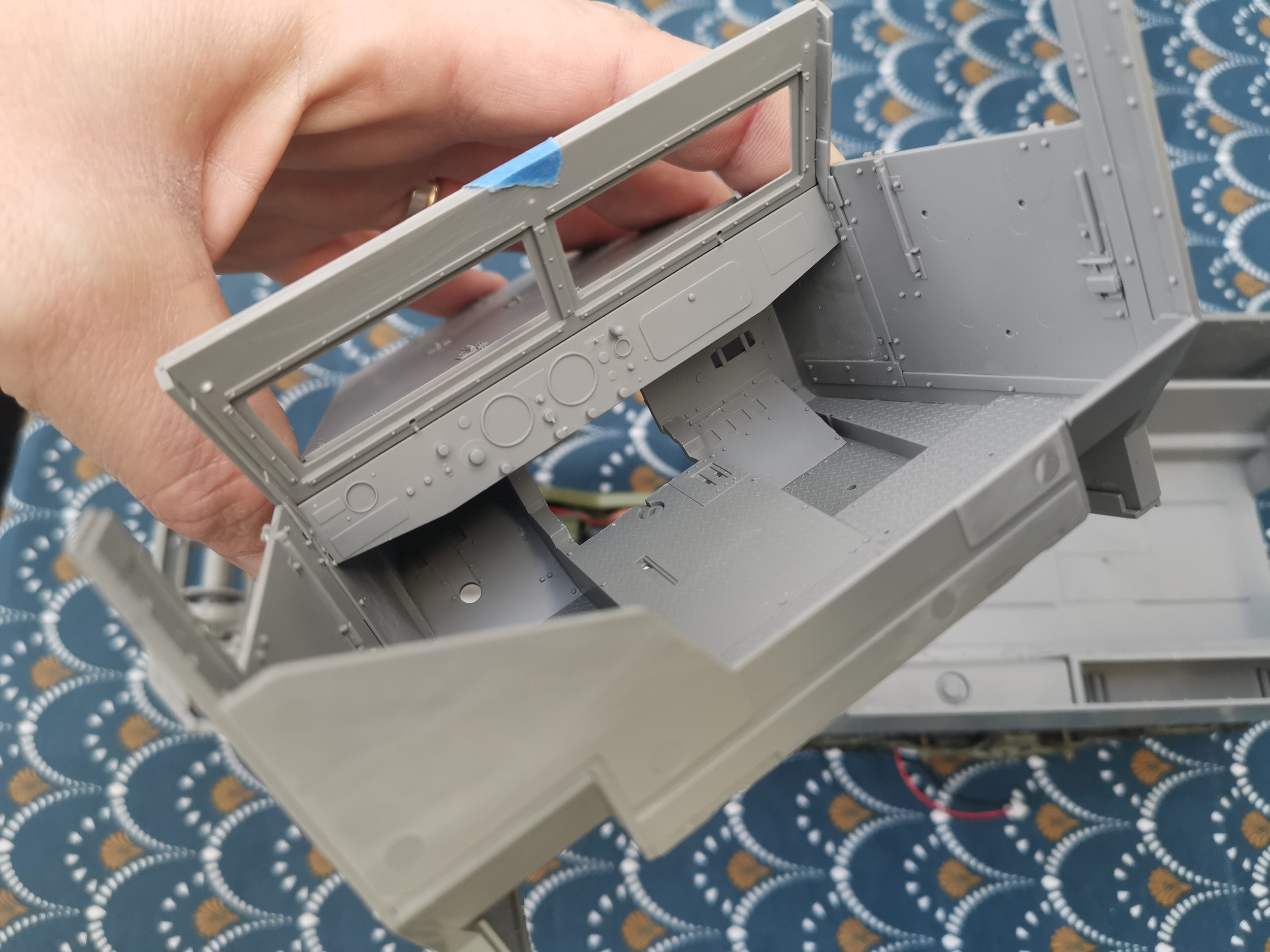

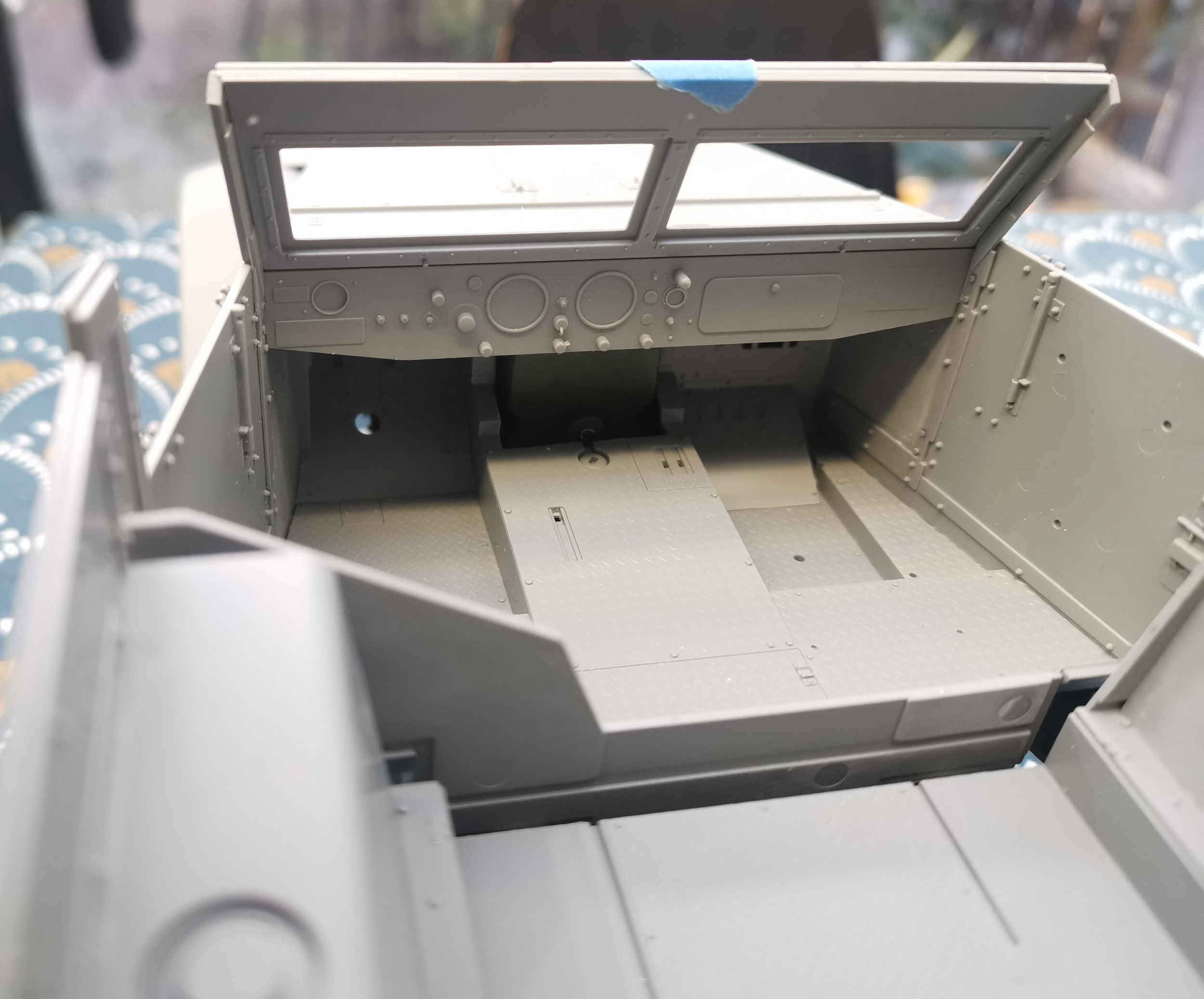

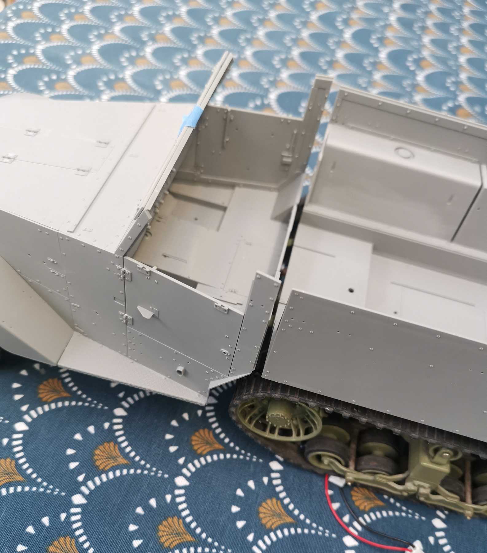

You can see the problem here, a 3mm gap.
It's easy to fix it by cutting 3mm off the rear of the chassis but you also have to move the cross frame by 3mm.
I had to creat an opening into the wall of the driving compartment to make room for the gearbox. It's not that visible and will be even less visible once the driver will be on the seat and the browning will be installed on top.

Yeah the Elmod seems to be a good option, however it's too pricey for me, I'd like to keep it as cheap as possible.
I already bought the elrctronics.
I had a 2.4ghz Flysky transmitter that I'm using for the DUKW, I just bought another receiver so I can let the other one inside the DUKW and this new one in the Halftrack.
I bought 2 motor controllers, one is the very cheap small one you can find on Aliexpress, it doesn't work very well, I also bought another one which is OK.
You can't put the electronics where they are on the M16 because the M3A1 has a lower floor (looks like the M16 has an extra metal floor plate that support the guns).
So for now, I think I can hide all the electronics elsewhere, under the engine hood, inside the fuel tanks etc... But I'm not sure about the battery. I don't want to use LIPO for safety reasons. I bought a small 7.2v battery, the original had a higher voltage, the M3A1 is very slow with 7.2v. And the battery is too big to hide it. I think I'm going to buy the same as the Torro one but it's quite visible under the chassis...
