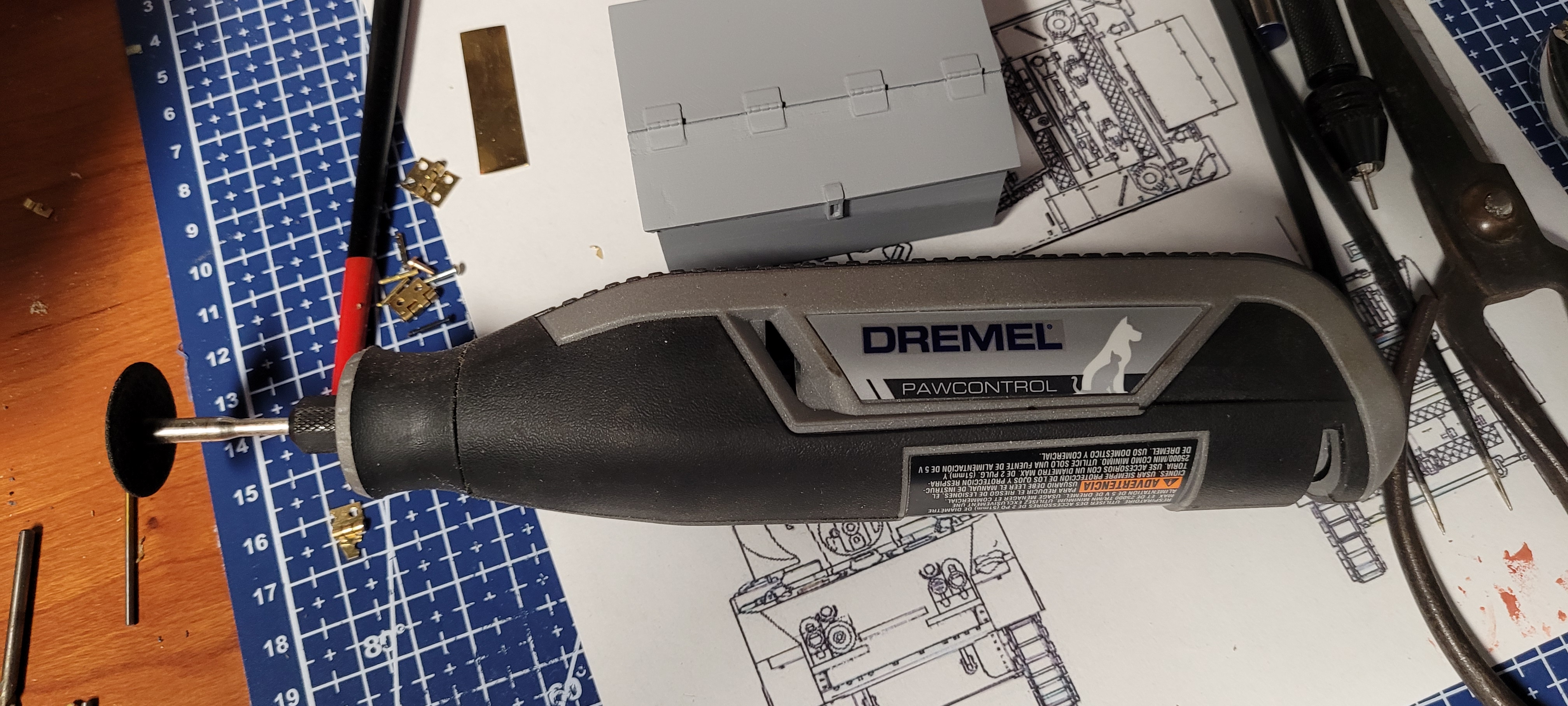

Picked up this"Pawcontrol" Dremel at a yard sale and what's great about it is that the first speed is incredibly low. Maybe less than 200rpm. Perfect for starting cuts or detail work. The next speed up is fast but still nowhere near as fast as a regular dremel. I'm sure the mach 1 rpm's of a regular dremel would roast a nailquick pretty fast. Recharges with a USB type C I think.
Lady I bought it from said her dog freaked out the first time she used it, so never again. Dogs are a modelers best friend!

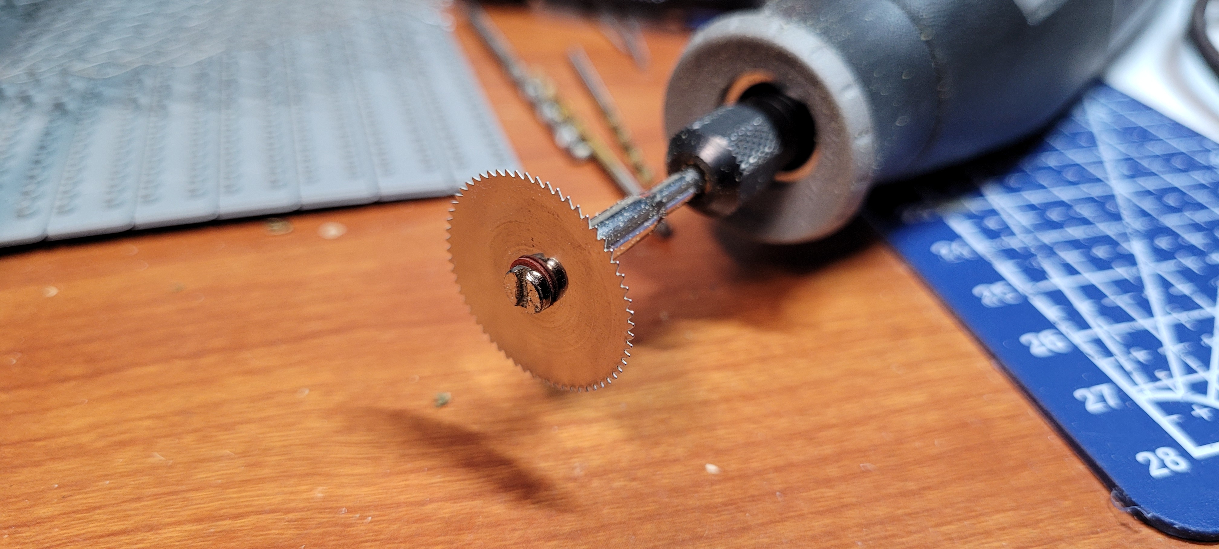

So far, it works well with a cheapo aliexpress saw blade. Can't push it as it's pretty low torque, but doing well on ABS.

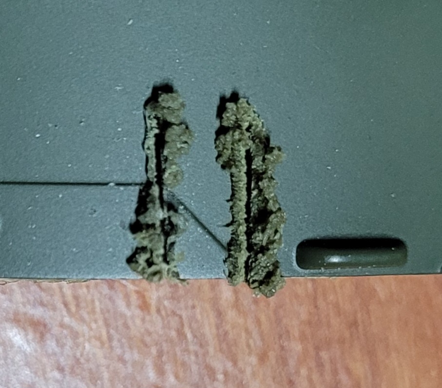

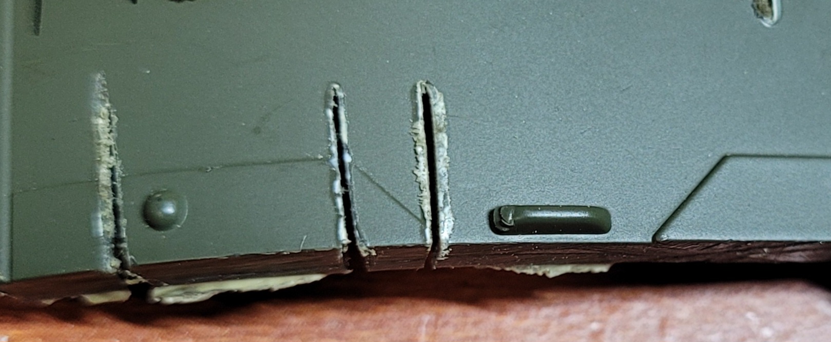

Here's a piece of 2mm thick abs from a Stuart fender with a couple of dremel cuts for comparison. Blade is one of those crappy aliexpress buzzsaw wheels.
The dog dremel on slowest setting is on the left, a regular corded dremel multispeed on slowest setting on right.
No severe melting from either on these short cuts, but the corded dremel definitely distorts and gets the plastic a bit melty/whitish looking on both sides of the cut after the fuzz--dare I say swarf?-- is removed.
Interestingly, I checked Dremel's site for specs and they're saying "speed 1" on the dog dremel is 8000rpm! There is no way that my fully charged dog dremel is even remotely close to the 5000rpm of my corded dremel. Dog dremel definitely does not have the torque of the corded model, but much nicer and controllable to me for those "take-a-deep-breath-you-got-this-Mike-steady-steady" cuts.
