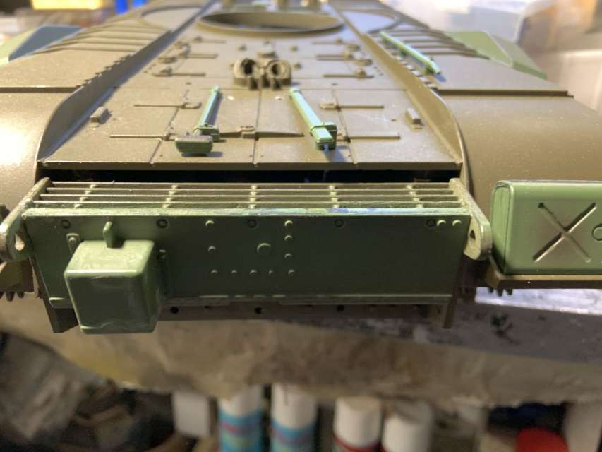

For me the 3 mm gap where the rear deck joins the rear vertical plate and the "step" on the front deck, were probably the 2 errors that made me contemplate eBay. This was closely followed by the innacurate periscopes,
First job was to saw down the four location points for the join between the hull and the deck. This was surprisingly easy and immediately fixed the "gap" and step issues. I fortunately kept the sawn off pieces as they'd be needed later in the build, although I didn't know this at the time. Next the 2nd drivers periscope needed reducing in height and detail needed to be added around the drivers and co-drivers periscopes as well as covers to all five scopes. As the build was done (and is still in progres over about 10 weeks it's hard to remember what wss done and in which order. I think next step was textuing the turret and adding welds to the turret top and where the top was attached to the cast turret. All this was totally new to me however there is guidance from this site and YouTube, for which I am deeply grateful 🙏 I'll add some pictures now and post more later in the week...

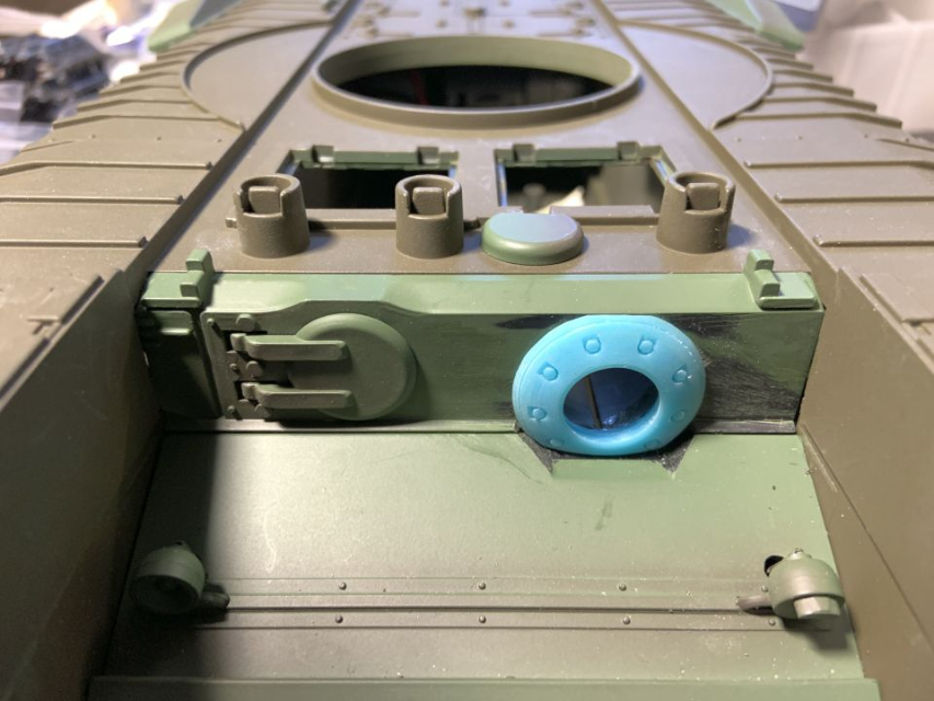

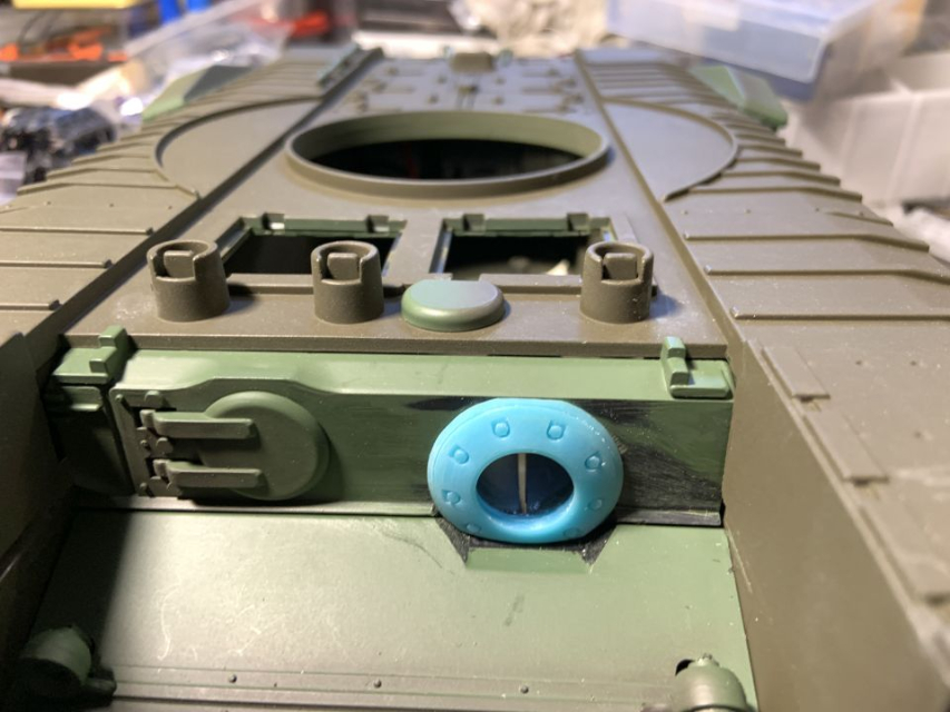

Hello,
here pictures:

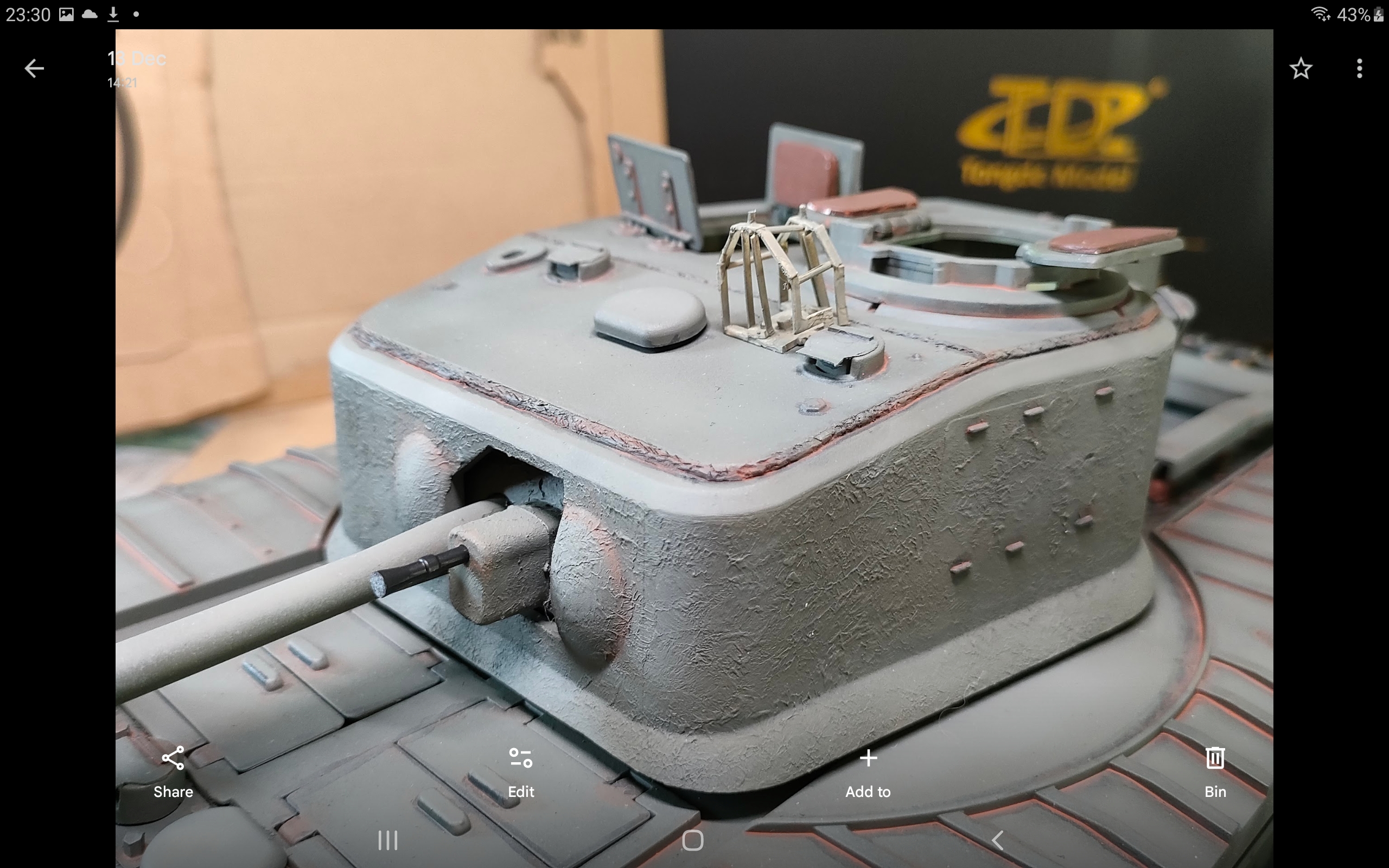

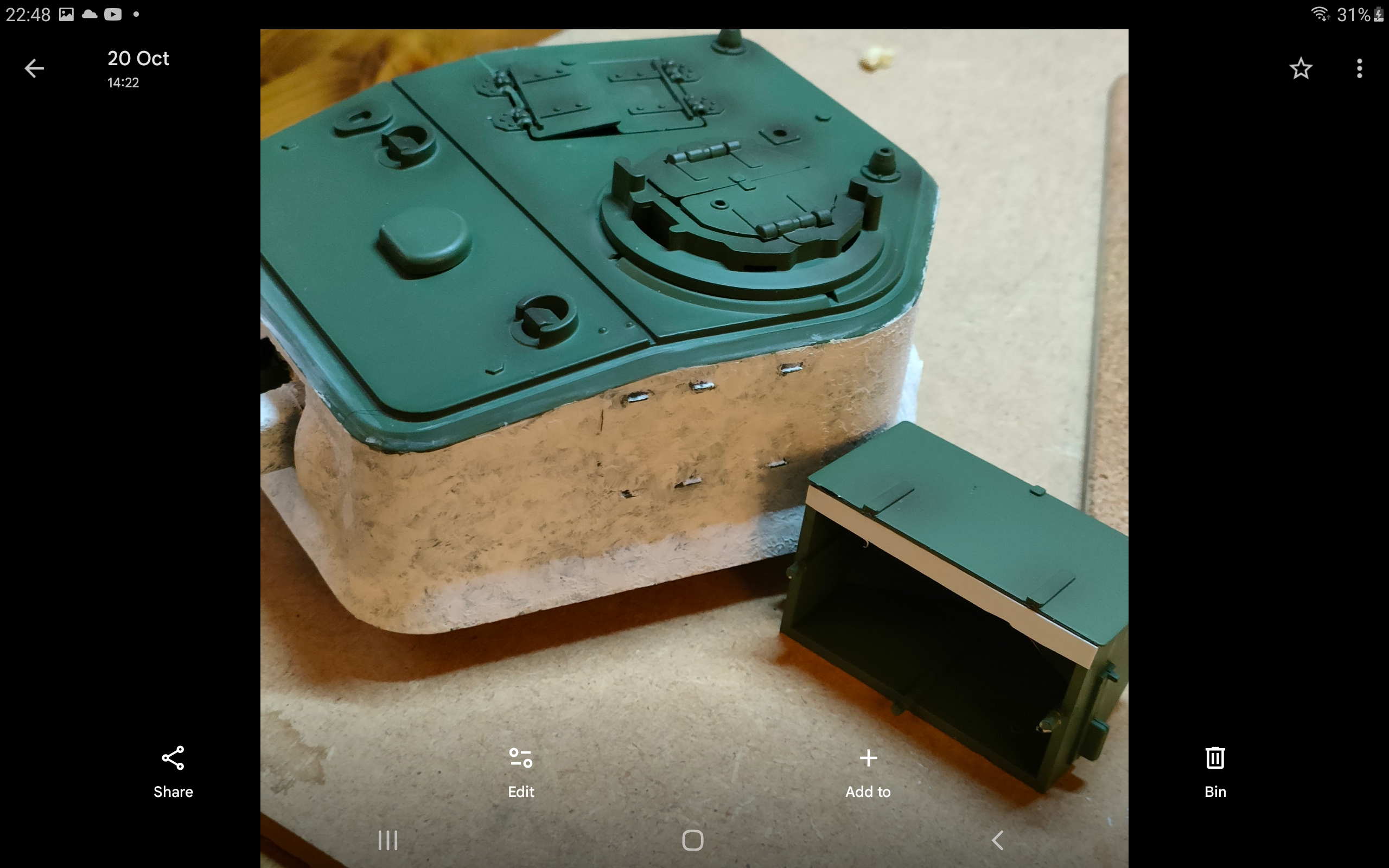

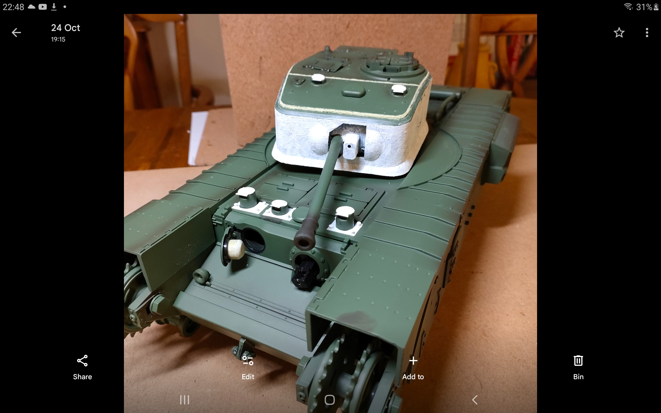

Cast texture to turret and back to turret bon
Deck lowered and mods to periscopes

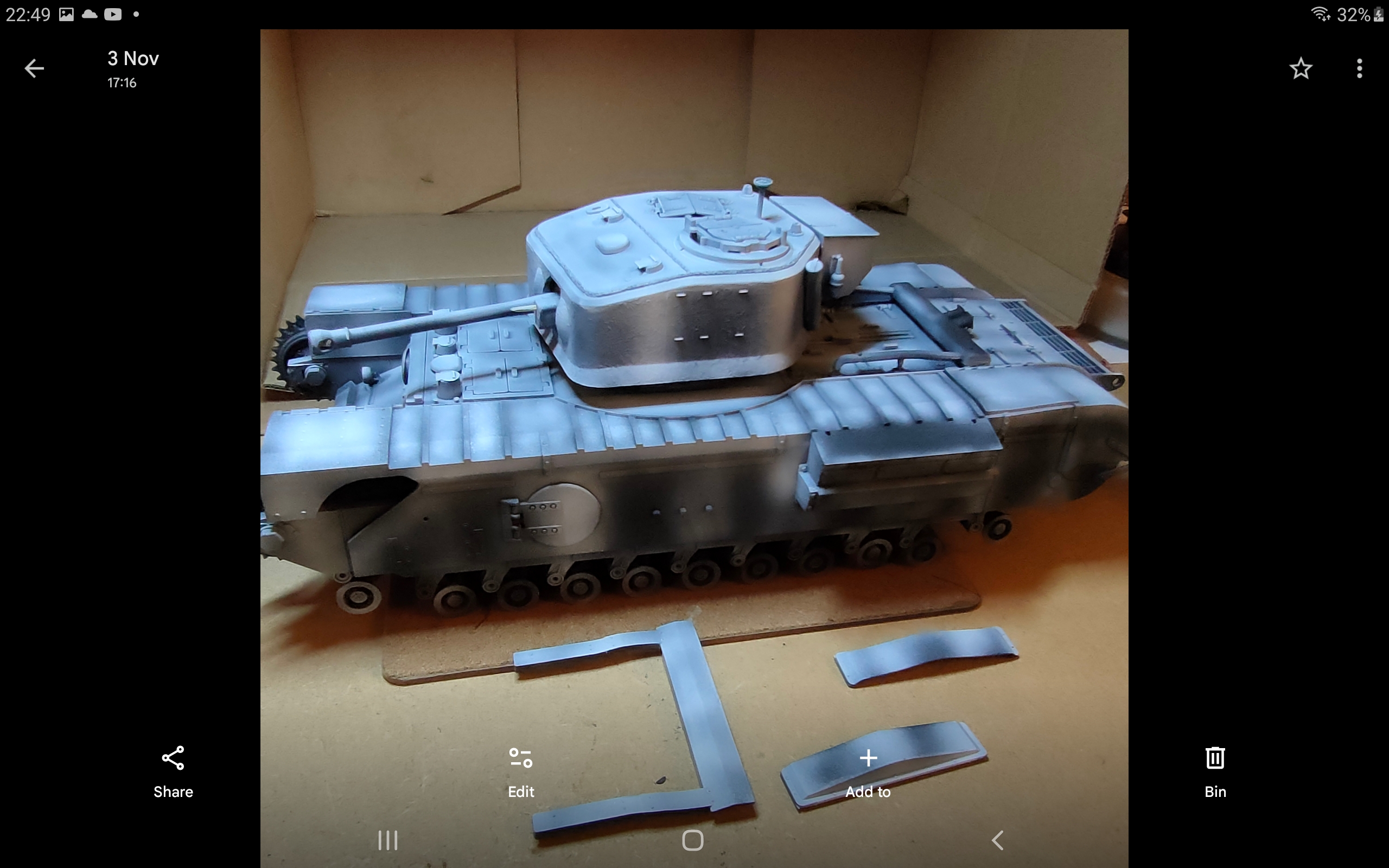

Churchill in black undercoat
White highlights
White highlights

Quickest way to reduce photo size was to take screenshot. Thanks for adding gap / step photos. This issue can also be seen in the images on the Motion RC site. So I guess it's a problem with the majority of the Churchills.

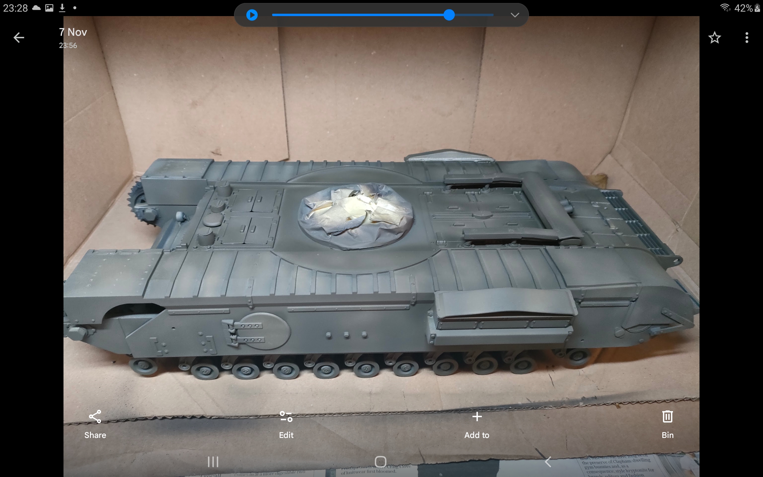

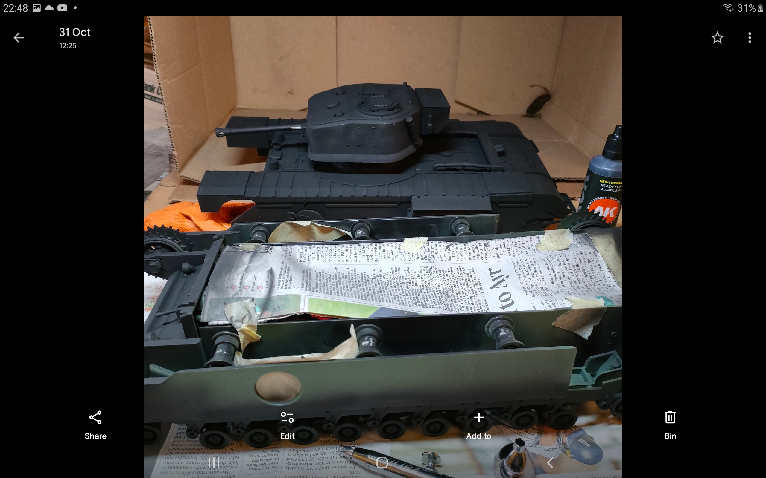

To avoid dragging on the deck scratching paintwork, the turret needs to be raised 1mm. I did this by adding a ring of plastic card to the turret base. This of course raises the turret ring which no longer engages with the turret motor gear. This is where the cut off parts of the hull bosses come in. I used these cut and shaped to lower the turret ring. While doing this I made new teeth in the turret ring, using a file and soldering iron to cut new teeth so allowing 360 degree rotation. Care needs to be taken using this feature to ensure cables aren't stressed!
Next was a coat of black primer followed by white highlights. Top coat was AK interactive SCC No 15 Olive Drab, in several light coats which to me looks fairly authentic. This was the first time for me using an airbrush and did indeed prove challenging at first and I'm glad I could practice on the undercoat lol. After a few weeks, I now feel pretty confident with the airbrush having gone through all the pain of learning.

Hull after olive green topcoat

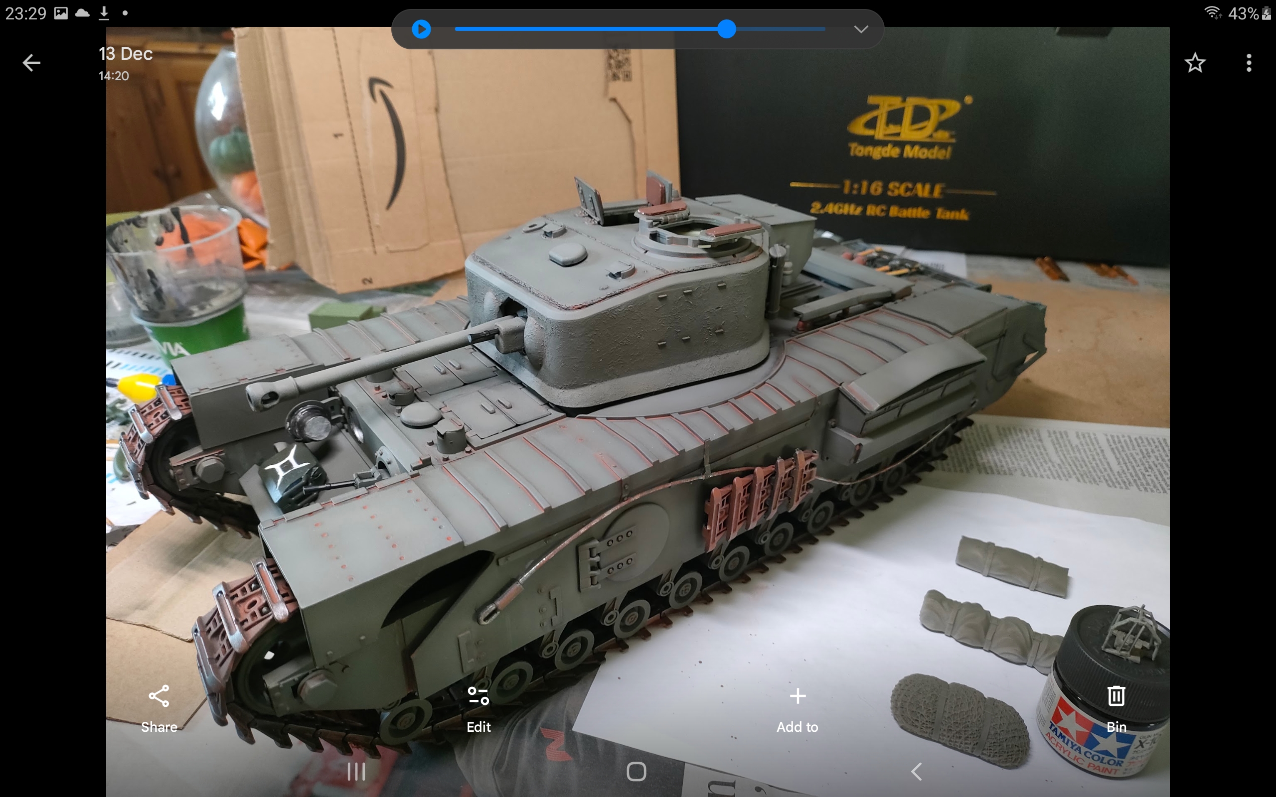

How the Churchill is looking now
Vane sight in primer & not yet attached
KeithT
Posts: 14
Joined: Sun Sep 14, 2025 8:32 pm
Re: Tongde Churchill Mk Vii ....toy or model
Post by KeithT »

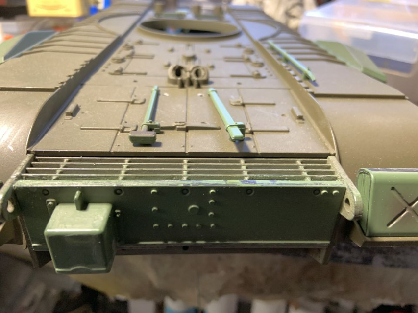

I've added some details including lenses in the lights additional spare track ( more to come ) a scratch built "birdcage" vane sight which i think is somewhat over-scale. I might have to remake smaller :headbang: :headbang: :headbang:
I have some stowage which needs painting and lots of spare track also got some waterslide transfers (decals) in order to make it into BRITON blatantly plagiarising a 1:35 model I saw on YouTube.
Also I've experimented with panel lining. I initially tried black but I didn't like it, just looked harsh and unrealistic. I settled on "old rust" which I think looks ok.
Once everything is added including transfers, I'm going to try a light spray of "dust" around the wheels and lower hull. I'll post some more images of the finished Model providing this last stage doesn't ruin it :haha:
