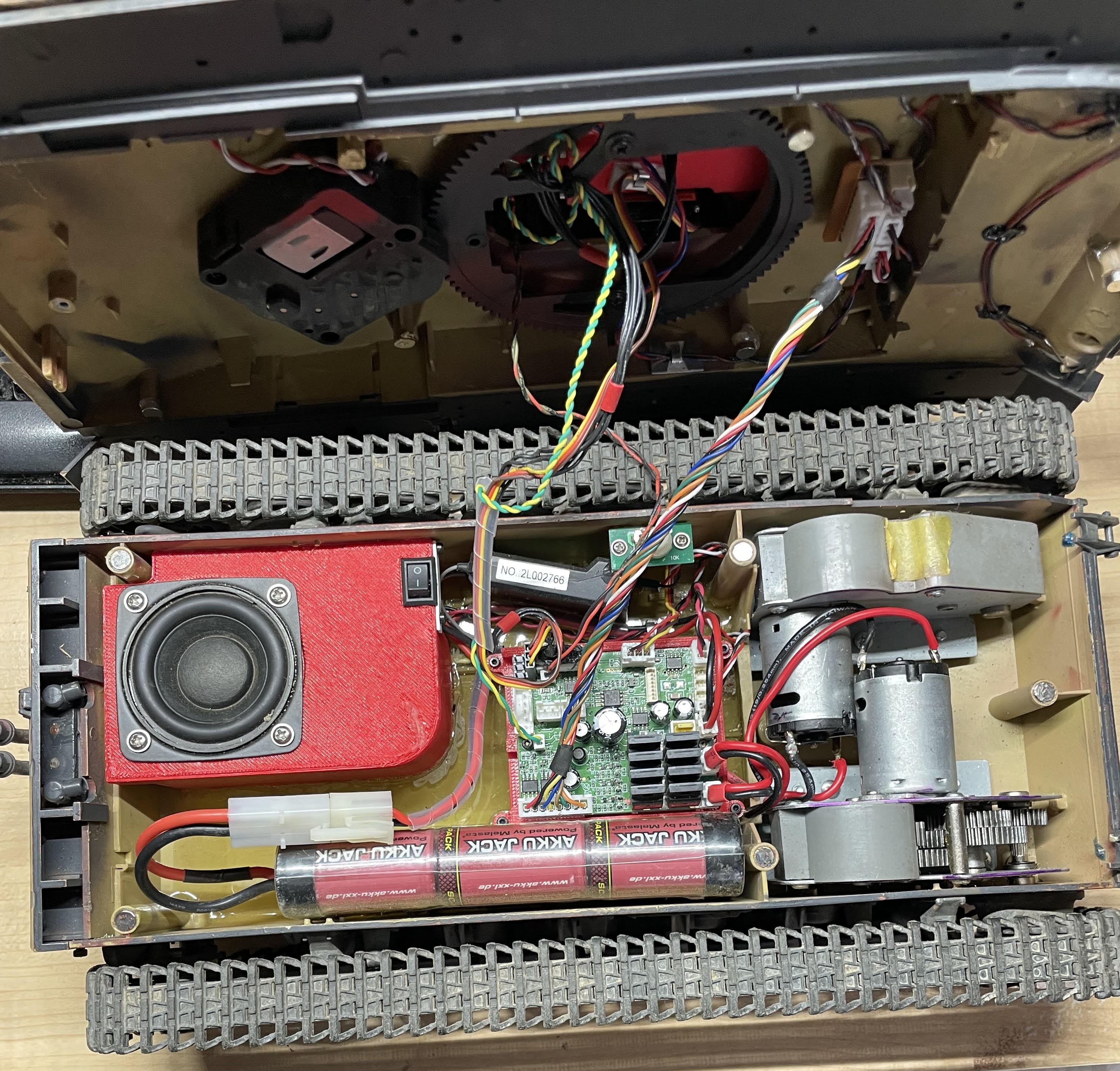

I am not sure which version you mean by "old one." If you can send a photo of the MFU ("multi function unit," the big board inside the bottom to which all the connectors go) we should be able to determine the vintage. Many of the newer tanks by most of the manufacturers are using LiIo (Lithium Ion) batteries of 7.4 volts, it might be good to determine the vintage of the MFU before changing to a different sort of battery and connector.

Here is the inside of my old HL Tauchpanzer III modified by Jarlath to show how well these things can be improved. The epoxy makes the hull very stiff. It's a great running little tank considering it is all plastic except the cheapo HL "metal" gearboxes but it is so light it doesn't need anything stronger

If you can post pics of the bottom of the tank or the transmitter we can at least tell you if it's a 27mhz (old) or 2.4GHz (newer) tank. Taking the top of the hull off as far as the wires permit won't hurt anything, and the PZIII is only 5 or 6 screws. Crafty ol' Panzermechaniker above has substituted in rare earth magnets to make opening it up even easier. And it's an RC tank--you'll need to be opening it up many times!
