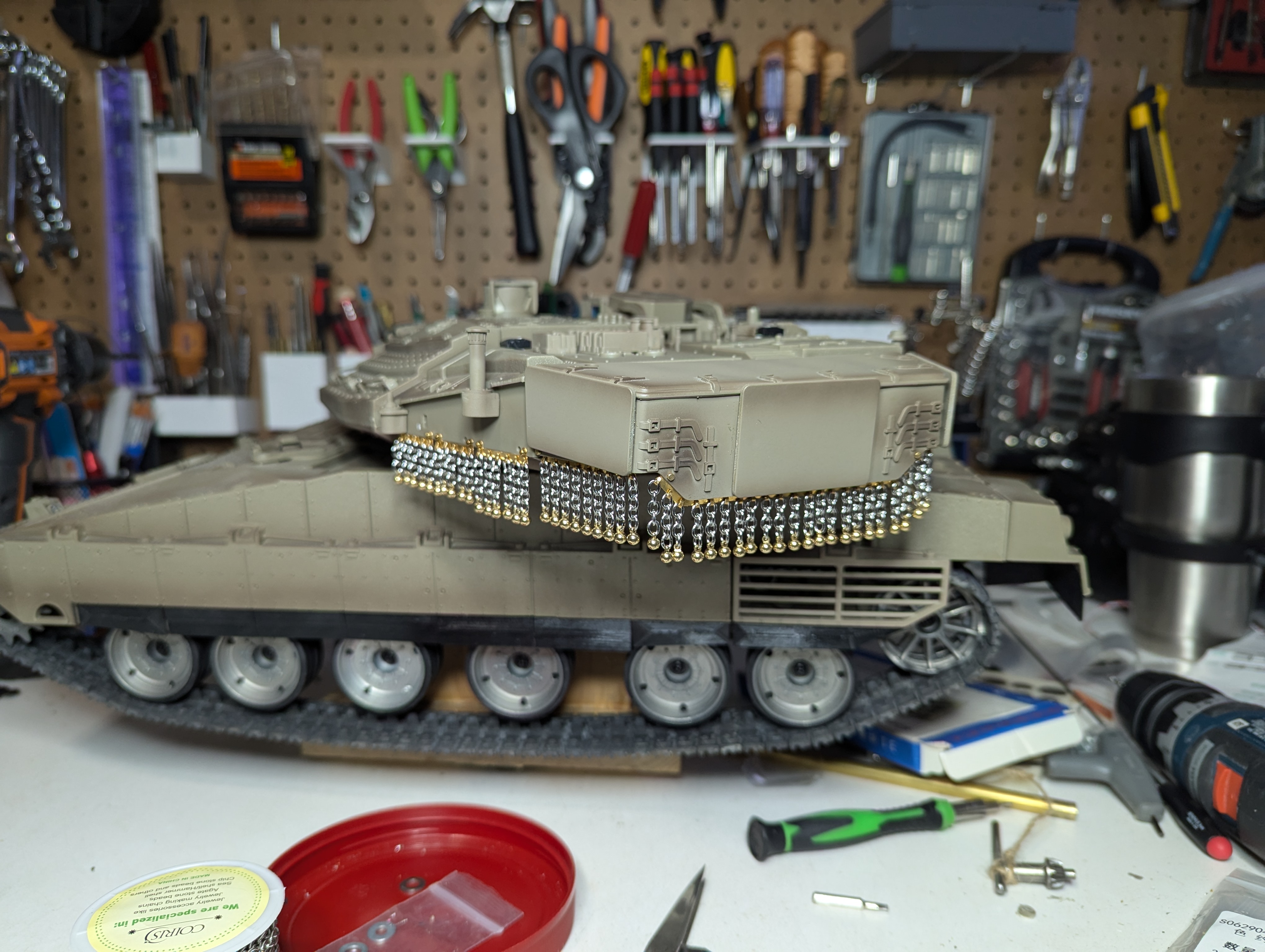

Technically the Russians were our friends up until the end of WW2. The most reliable tanks in my fleet are the T34 series. Out of the three you have listed, the Merkava is probably the most reliable, but yeah there isn't really that much to do with it unless you want to go full ham on one like me by adding the sand anti-slip texture and replace the out of scale Heng Long ball/chains with brass balls and better chain. I also 3D printed some new lower side skirts out of a flexible material and replaced all the mud flaps with flexible pieces.
Modern tanks have so much detailing that can be done to them. I've only been working on my M1A2 SEPv2 Abrams since oh...like 2014.
