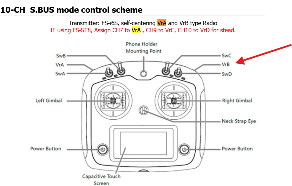

I have purchased a tk50 s .I have connected it with a flysky I6S RADIO .Tank drive's I have a speaker and volume connected and sounds work machine guns fire .The cannon seems te be firing as heard through the speaker at will . What switch on the radio is supposed to fire the cannon ? Can the board produce sound without a cannon connected . I am doing this as can afford it so as of now I have not cannon connected . Thank you for your help

The switch that fires the canon is the VRB roller switch on the very top right of the radio. You pull the round switch one direction and the MG will fire, push it the other way and the canon will fire. The VRA round switch on the top left should have another MG sound when you use it, but it only has the MG and nothing else.
Screenshot 2025-11-01 005134.png (287.33 KiB) Viewed 1306 times
If you are having an issue with it firing at weird times, I would go back through the radio configuration from here and verify everything is correct.

I got an answer without an airsoft gun connected , bthe speaker will not make sound because its waiting for a trigger signal from the gun . Thank you guys for your help.

I connect a Henglong recoil BB AIRSOFT and now the speaker makes firing noise for cannon. Very cool.
