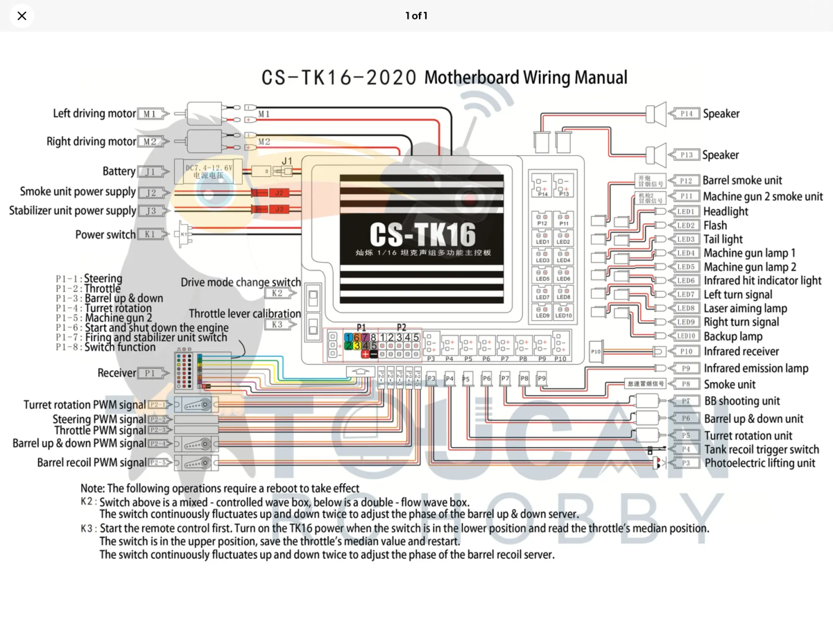

Does anyone have any experience with the TK16 boards bought from Toukan Hobby?
It has caught my interest as im thinking of building a modern tank, Toukan offer a turret/barrel stabilizer unit and that is plug and play. Im just wondering is it any use?
The only other systems for barrel stabilizers would be Tamiya and Clark TK60G2.
This looks quite plug and play with Henglong.ImageImage

Clark TK60 series has been discontinued for years. The TK16 is made by Canshuo. It's not a well documented board. There is a video online that shows how to use it as it normally comes speaking in Chinese. In addition the below screenshot, I have a PDF file with some info in it, but it's a bit cryptic. I'll post it in the files section.
CS TK16 English.png (746.28 KiB) Viewed 1208 times
