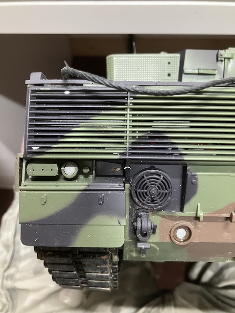

Been bitting and bobbing on this, and just enjoying it for what it is. Now the modifications have started. Tried the headlight work shown by Mr-Tank-Alot. Didn’t work, as the headlights stopped working. Drilled out the old LEDs and installed new smaller ones. So some reason known only the Heng Long, the taillights are where there are reflectors. After removing the LEDs the resulting holes were filled, and a start was made on installing brake lights, taillights, and indicators, in a more prototypical position. This is where the TK7.0. & TK7.1 are great as this will be plug and play, when the wiring is done.
