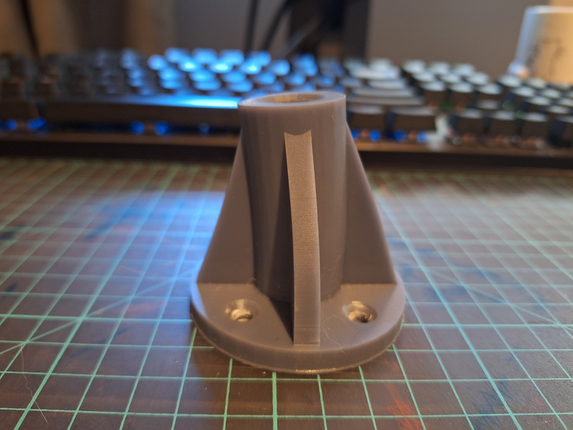

I usually mix Siraya Build with Bly Nylon as 3 parts to 1 part first, and add 10% of Tenacious (1 to 10 of the total mix) as a second.
I wasn't sure about tracks in resin because under some heat and load I'm having results like this.
