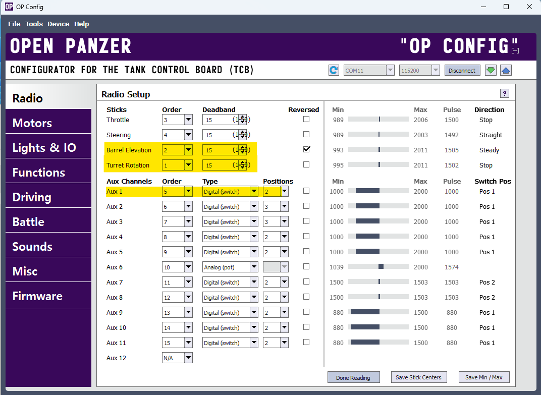

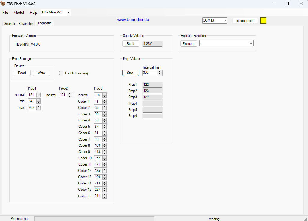

Hi Luke,
I'm wondering if you could help me understand how DasMicro communicates with the OP board.
I uploaded the standard OP config to DasMicro, and it seems to be working as I want, but I don't understand how I can assign Prop 2 & 3 outputs.
and Prop3 to
When I'm reading Prop settings on the Mini, Prop 2 is linked to the Aux1 channel, and Prop 3 to the Stik channels 1 & 2 (turret rotation and gun elevation).
Is this setup fixed, or is there a way to change it?
and Prop3 to
- MiniV2_Diagnostic.png (47.09 KiB) Viewed 1267 times
- OpBoard_RadioSettings.png (80.64 KiB) Viewed 1267 times

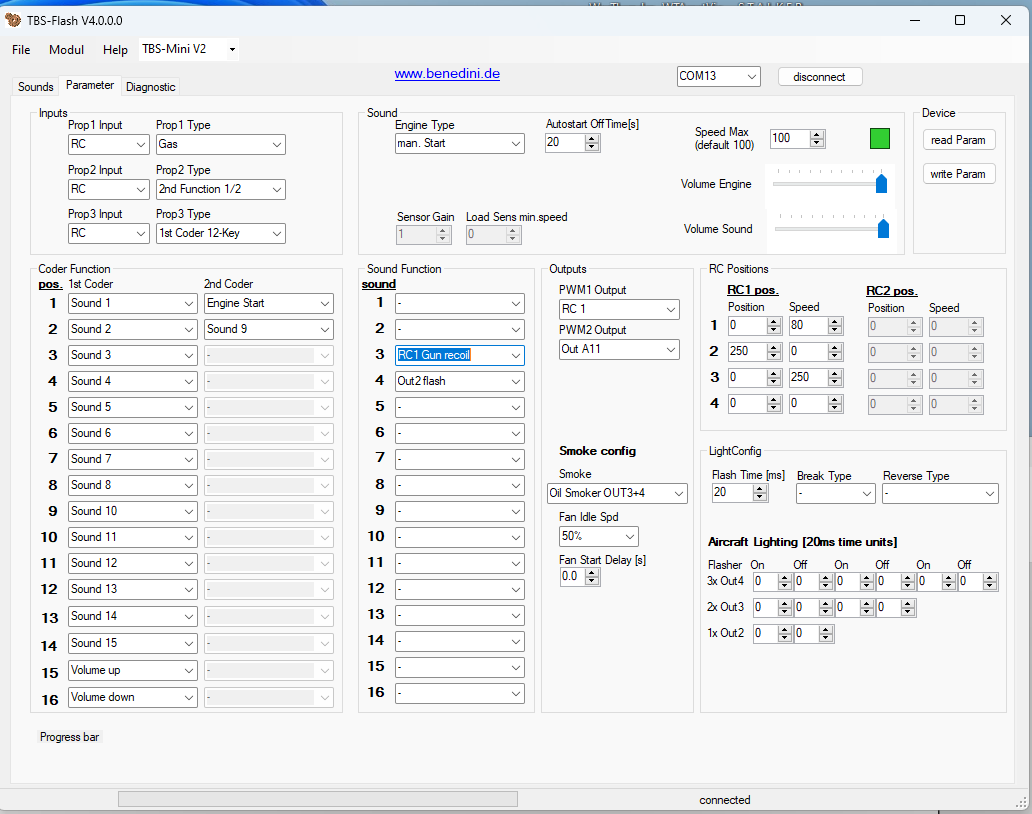

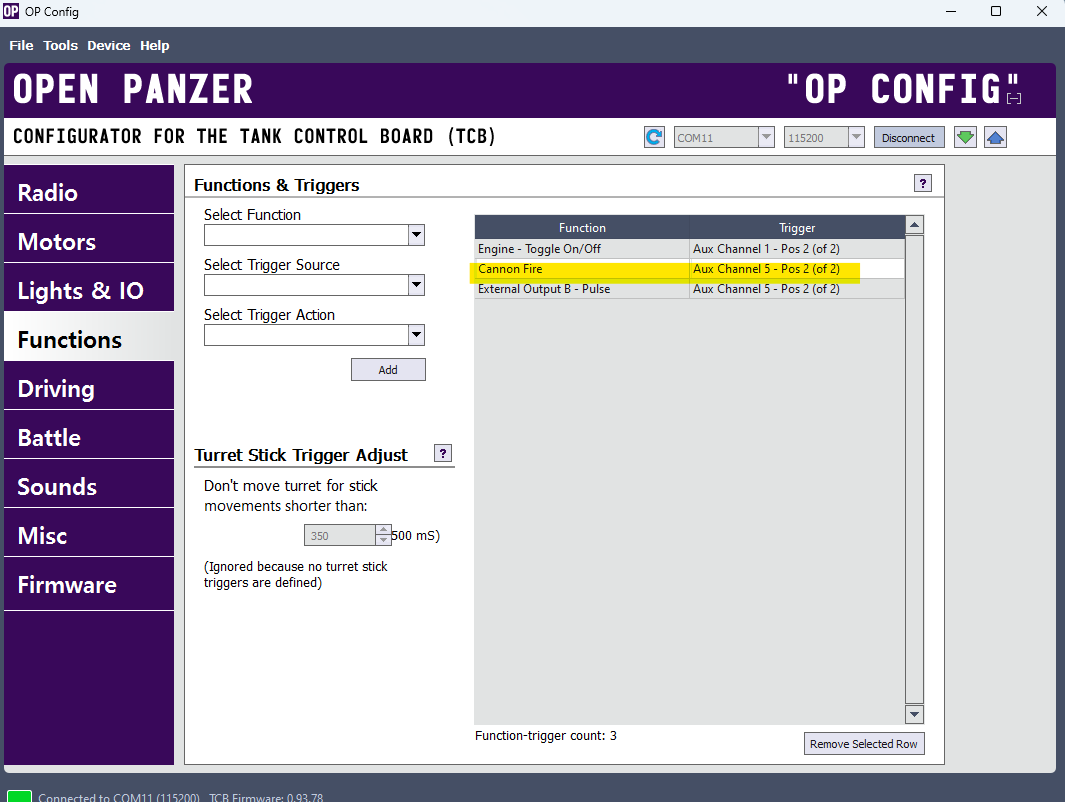

Also, I assigned canon fire to Aux 5 (momentary switch) via the Functions tab, and it's working with DasMicro, but I don't understand how.
In the Mini Parameters tab, Prop 2 is assigned to 2d encoder functions 1/2 (engine start/repairs (sound9)), Prop3 to 1st Coder 12-Key - turret rotation (sound 1)/gun elevation (sound 2).
Sound 3 (canon fire) to sound function RC1 Gun recoil, but I'm not sure what it means.
Can it be modified/adjusted as well, if I want to add machine guns, for example?
- OpBoard_Functions.png (50.9 KiB) Viewed 1265 times
- MiniV2_Parameters.png (86.74 KiB) Viewed 1265 times

Hi Art, I'm not sure I understand the question exactly. But the Mini has three "Prop" inputs (proportional inputs). These are connected to the three Prop outputs on the TCB. The TCB doesn't give you direct control over those outputs - Prop 2 is not linked to an Aux channel, nor is Prop 3 linked to the sticks. You do not control the Prop outputs directly, the TCB controls them.Art Hogus wrote: ↑Fri Aug 29, 2025 11:32 am Hi Luke,
and Prop3 to
On the Mini, Prop 1 is the signal that plays the engine sound. Prop 2 plays two additional sounds, which we've assigned to engine start and repair. Prop 3 can play 16 sounds (or in our case 14, and the other 2 slots are reserved for volume up/down).
The TCB handles the sending of those prop signals to the Mini when those events are needed. It sends the engine speed signal to Prop 1 automatically whenever the engine is running. When you start the engine, it sends the appropriate signal through Prop 2 to play the engine start sound, likewise if you receive a "repair" hit. The appropriate commands on Prop 3 are sent when those events happen. When you fire the cannon on the TCB, the TCB then performs all the actions related to cannon fire, which are numerous: flash, barrel recoil, tank recoil, IR, etc... but also in that list is the necessity of sending a special signal out Prop 3 to the TBS Mini so that the Mini will play the cannon fire sound, which the TCB takes care of for you.
In this way the TCB controls the Mini, you are not controlling it directly from your radio. Your Aux 5 switch doesn't do anything to the Mini, it just tells the TCB to "fire the cannon." The TCB then knows what to do for that event, and will send any signals required to the Mini.
If you want a second machine gun, just add that sound to slot 11 in TBS flash as it shows in the Wiki, then assign some trigger to the 2nd Machine Gun function in OP Config, and the TCB will take care of linking them. If you want a 3rd machine gun, you'll have to use some of the User Sounds and setting up functions in OP Config to play and stop those. For the light for a 3rd machine gun you'd have to use the Aux output or one of the General Purpose I/O outputs, if any of those aren't already being used for other things. There is no built-in function for a 3rd machine gun, so you'll have to assign multiple functions to a single trigger to handle the light and sound.
I hope that helps, but if you still have a question maybe you can rephrase it or describe exactly what you're trying to accomplish.

Thanks a lot, Luke, for your help. It is much clearer for me now.
I'm not quite sure how '2d function 1/2' works on the Mini.
Do I need to use a 3-position switch to assign repair sound to Pos 3 (of 3)? Can it be played automatically after some event like 'Canon hit"? Can both Canon hit and repair sounds be played automatically as the sequence?
I'm using the General Purpose I/O B port for the standard LED as a cannon flashlight. I'm planning to use I/O port A for the barrel smoker (as per OP wiki)
So, what would be the best way to set up a second machine gun light? Should I use Mini for it?

Sorry, I wasn't sure what 'Prop' stands for. For some reason, I thought it was direct output.LukeZ wrote: ↑Sat Aug 30, 2025 6:30 pm Hi Art, I'm not sure I understand the question exactly. But the Mini has three "Prop" inputs (proportional inputs). These are connected to the three Prop outputs on the TCB. The TCB doesn't give you direct control over those outputs - Prop 2 is not linked to an Aux channel, nor is Prop 3 linked to the sticks. You do not control the Prop outputs directly, the TCB controls them.
Regarding the engine start sound, I assigned 'Engine -Toggle On/Off' to a 2-position switch as you recommended. So for now, it plays only the engine start sound, and I can't switch between engine start and repair sounds manually.Prop 2 plays two additional sounds, which we've assigned to engine start and repair. it sends the appropriate signal through Prop 2 to play the engine start sound, likewise if you receive a "repair" hit.
Thanks a lot again! I wasn't quite sure what the '1st coder 12-Key' means and how it works. Basically, any function/event associated with relative sound will be played once triggered. Is it right?Prop 3 can play 16 sounds (or in our case 14, and the other 2 slots are reserved for volume up/down).
The TCB handles the sending of those prop signals to the Mini when those events are needed.The appropriate commands on Prop 3 are sent when those events happen. When you fire the cannon on the TCB, the TCB then performs all the actions related to cannon fire, which are numerous: flash, barrel recoil, tank recoil, IR, etc... but also in that list is the necessity of sending a special signal out Prop 3 to the TBS Mini so that the Mini will play the cannon fire sound, which the TCB takes care of for you....
The TCB then knows what to do for that event, and will send any signals required to the Mini...
If you want a second machine gun, just add that sound to slot 11 in TBS flash as it shows in the Wiki, then assign some trigger to the 2nd Machine Gun function in OP Config, and the TCB will take care of linking them. If you want a 3rd machine gun, you'll have to use some of the User Sounds and set up functions in OP Config to play and stop those.
Regarding AUX output, I'm using a separate heat and fan smoker, so the air pump is connected to AUX.For the light for a 3rd machine gun you'd have to use the Aux output or one of the General Purpose I/O outputs, if any of those aren't already being used for other things. There is no built-in function for a 3rd machine gun, so you'll have to assign multiple functions to a single trigger to handle the light and sound.
And there is a bit irrelevant question regarding OP sound card. Is it compatible with PJRC Teensy 4.0, and if not, are you planning to make it compatible? I would rather use OP sound card than the Mini.

You don't need to assign anything to the repair sound, you only need to load the repair sound into TBS Flash and make sure whatever sound number it is, shows up in the 2d coder column as shown in the Wiki. The TCB will tell the Mini to play the repair sound, whenever it detects that you have received a repair IR signal. So it is not you that trigger the repair sound from your transmitter, it is the fact that the TCB has detected a repair IR signal. Likewise the cannon hit sound will be played automatically when you are "hit" with an IR battle signal - this is not something you control from your transmitter, nor do you need to assign any functions to it in OP Config.Art Hogus wrote: ↑Sun Aug 31, 2025 1:24 am Regarding the engine start sound, I assigned 'Engine -Toggle On/Off' to a 2-position switch as you recommended. So for now, it plays only the engine start sound, and I can't switch between engine start and repair sounds manually.
Basically, don't concern yourself with trying to trigger the sounds on the Mini. Load the sounds into the Mini, yes; arrange them in TBS Flash as shown in the Wiki, yes. But let the TCB take care of telling the Mini when to play them. If your battle opponent shoots you with his IR transmitter, the TCB will tell the Mini to play the cannon hit sound. If someone sends you the repair IR signal, the TCB will tell the Mini to play the repair sound. If you tell the TCB to start the engine, the TCB will tell the Mini to play the engine start sound. You are not controlling the Mini, you just need to control the TCB. If the sounds are in the right places on the Mini, the TCB will take care of playing them when needed, you don't have to do anything extra for that.
Yes. I believe Thomas called this "12-Key" because in older versions it only supported 12 positions (sounds), but later was expanded to 16. If you were using a Mini with your radio, you were supposed to install a 12/16 position switch on your transmitter, then turn the knob to whatever position you wanted to play the sound in the slot. Not only does that require modifying your transmitter, a 12/16 position switch is pretty impractical to use manually. But the TCB can easily create a 16 position switch in software, and knows to send the correct position to the Mini when a given event occurs.
If you are only trying to set up a 2nd machine gun (not a third as I had assumed), then it is very easy since the TCB supports 2 distinct machine guns already. The light output for the 2nd Machine Gun is labelled L2 on the TCB board, just plug your light into that. Use the "2nd Machine Gun - Fire" and " - Stop" functions in OP Config to assign it to whatever switch you want. Place your second machine gun sound in the correct slot in TBS Flash (1st coder slot 11, also called User Sound 3). That's all you have to do. This is all in the Wiki!Art Hogus wrote: ↑Sun Aug 31, 2025 1:24 am Regarding AUX output, I'm using a separate heat and fan smoker, so the air pump is connected to AUX.
Unfortunately the later versions of the Teensy do not have the sound capabilities that the 3.2 did, or else I would have been happy to port the firmware over to the new Teensy designs. So for all intents and purposes, the OP Sound Card is now a dead project, except for those who still have a Teensy 3.2 left over from the old days. It's a sad outcome, and for more projects than just this one. PJRC invested a lot of time and energy into the audio capabilities of their Teensy 3.x hardware, and countless other developers made some great applications using it, but the chips on those boards were one of the casualties of the Covid debacle, and the supplier did not choose to or was unable to resurrect them afterwards.
