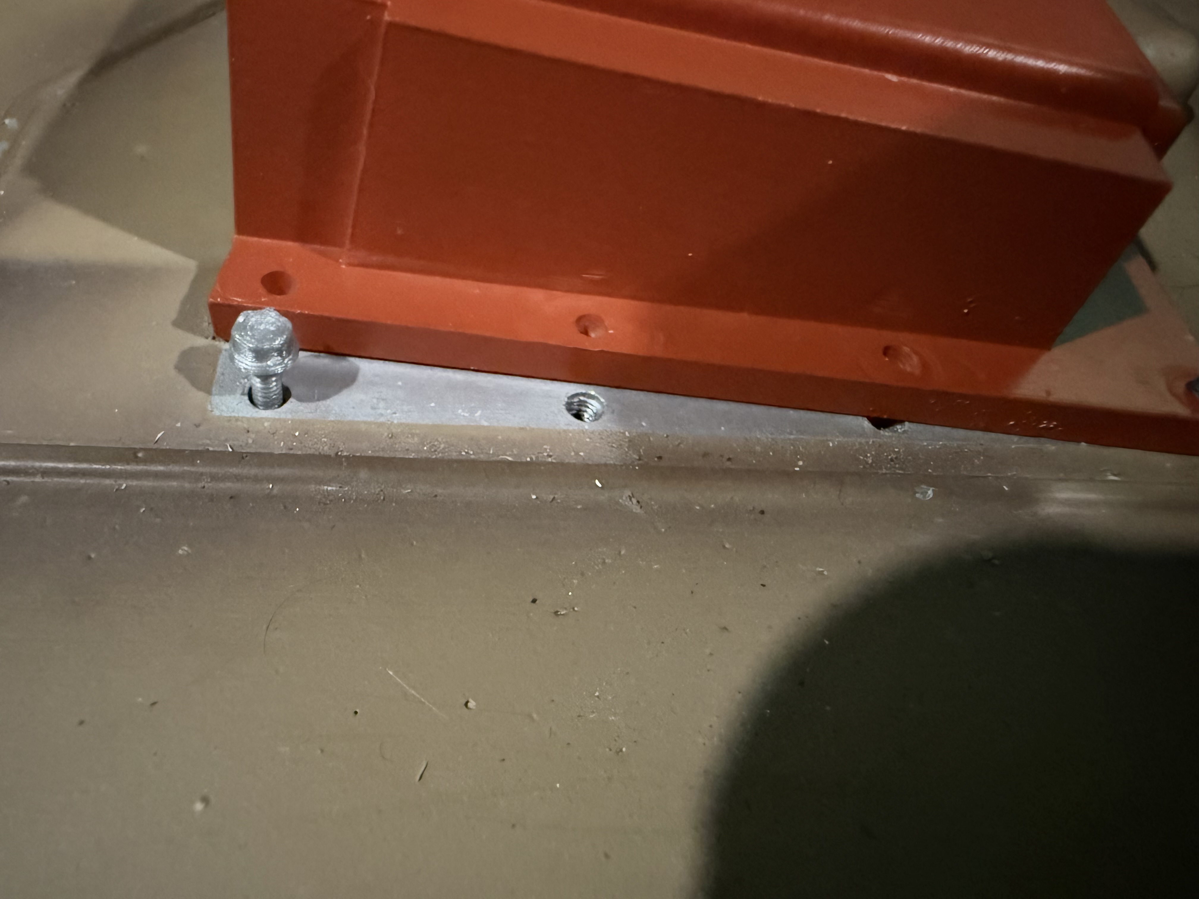

So I’m looking to see if anyone knows a way to make a screw hole that has already been drilled and tapped smaller to accommodate a smaller sized screw.
In my 1/8 model, for some aesthetic bits they bolted them on with M3 hex screws. I think it would look better if they used M2 hex screws, but the holes are already there.
I was wondering if anyone had any idea of a way to do this? The only thing that came to mind was filling the holes with body fill and re-drilling and re-tapping them, but I don’t know if this would work or not. Moving the items and drilling new holes in a different position is not an option for most of the things I want to do this with.

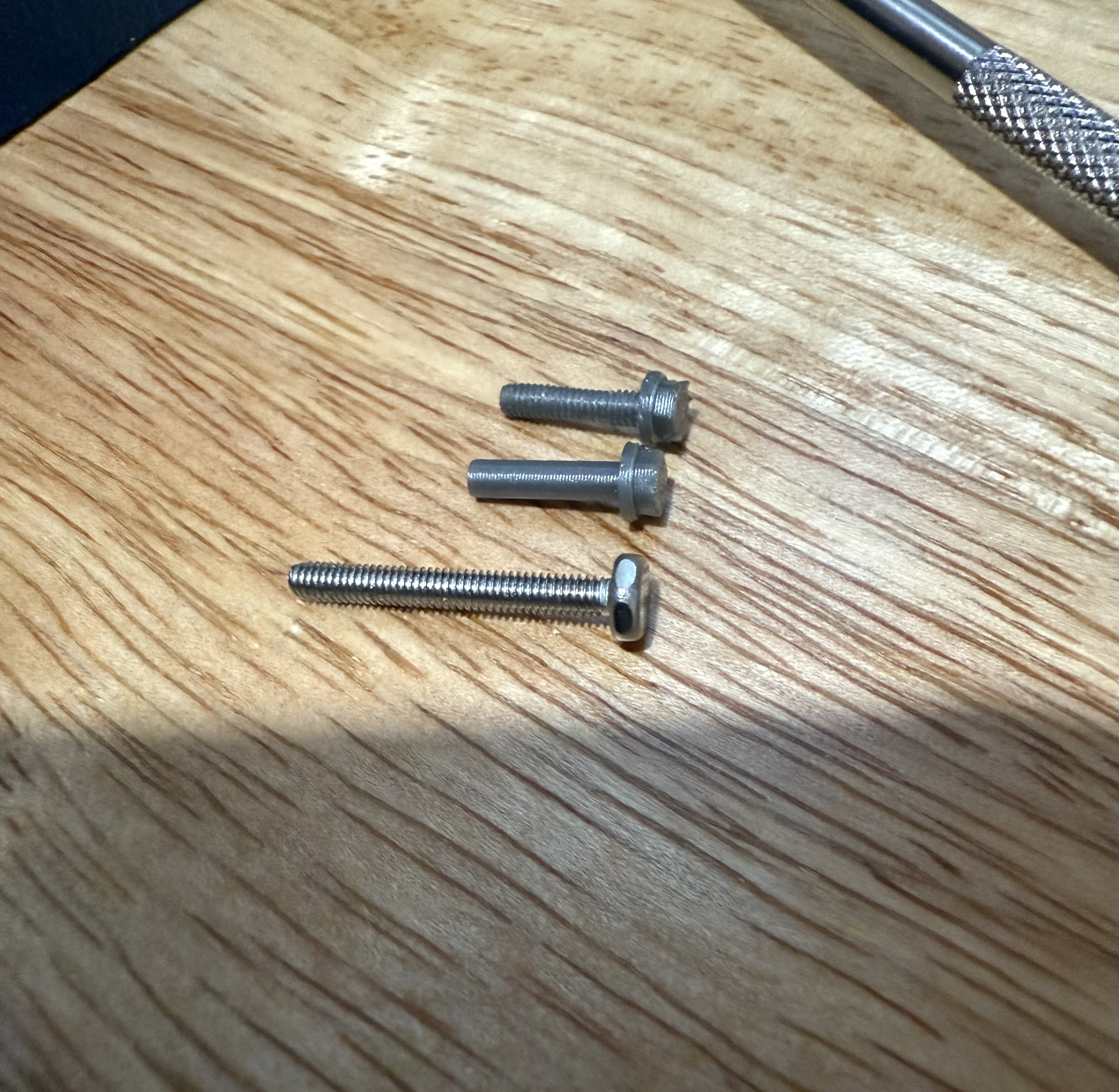

Great success!
Going to do a little tweaking so the bolt head fits in my M3.5 socket, then it should be good to go.
Top: threaded fake bolt<br />Middle: Fake bolt fresh off the press<br />Bottom: Actual 2.5mm hex bolt
It screws in, and holds when gently tugged on, which is all I’m asking here. I’m not trying to bolt on motors or anything
