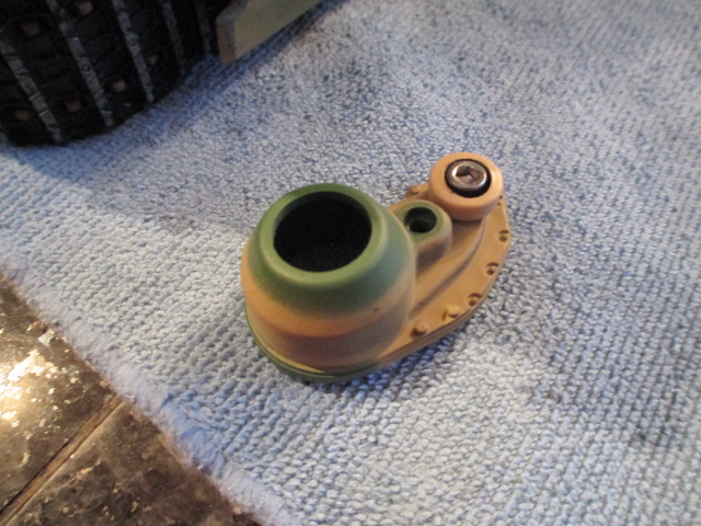

https://www.forgebeartanks.com/store/p1 ... _tank.html
Taigen Panther G front transmission covers
If they fit on the heng long is another question, someone might be able to answer that for you.
- Posts: 7985
Re: Obtaining a return roller for my panther ausf G

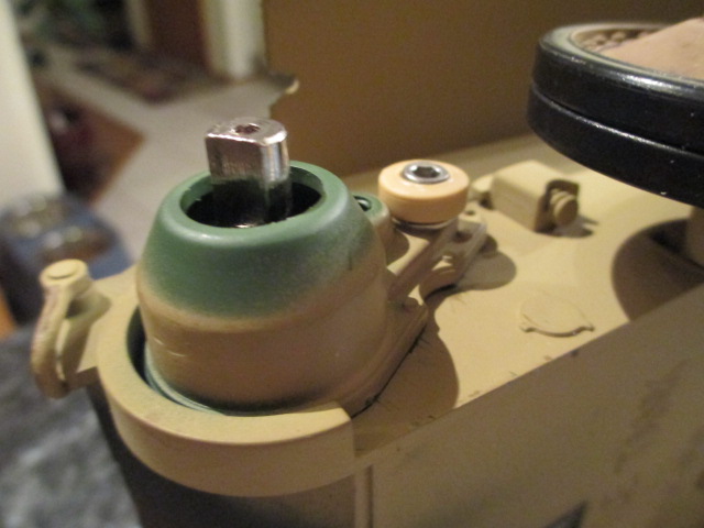

Good Morning,
From the Website: "They fit the Taigen Panther G metal base, but could be made to fit Heng Long" Sounds like a little modeling will be called for but in the end, they will do the job. Back when I was detailing my Panther G and adding these wheels, I just drilled and added wheels that I got from a Website, either RCTanks.de or Welsh Dragon *Spotty old Wolf memory* Next time around, I am just going to get the Taigen metal Lower and paint it to match the Upper. Have fun and take Pics, Techno!
