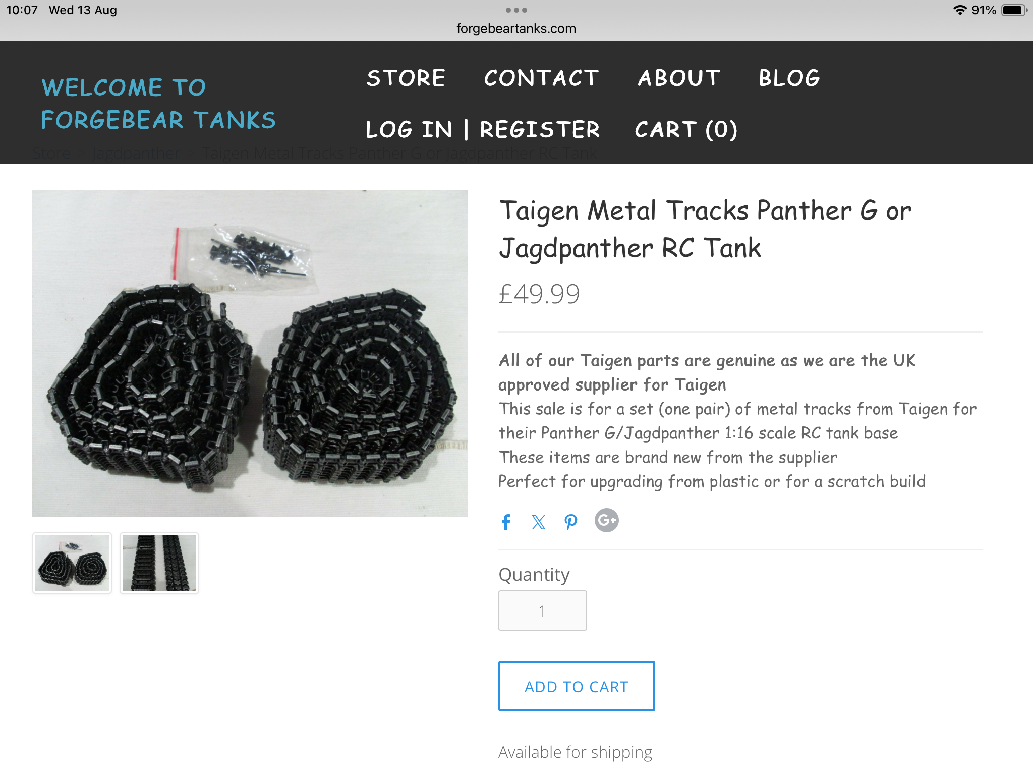

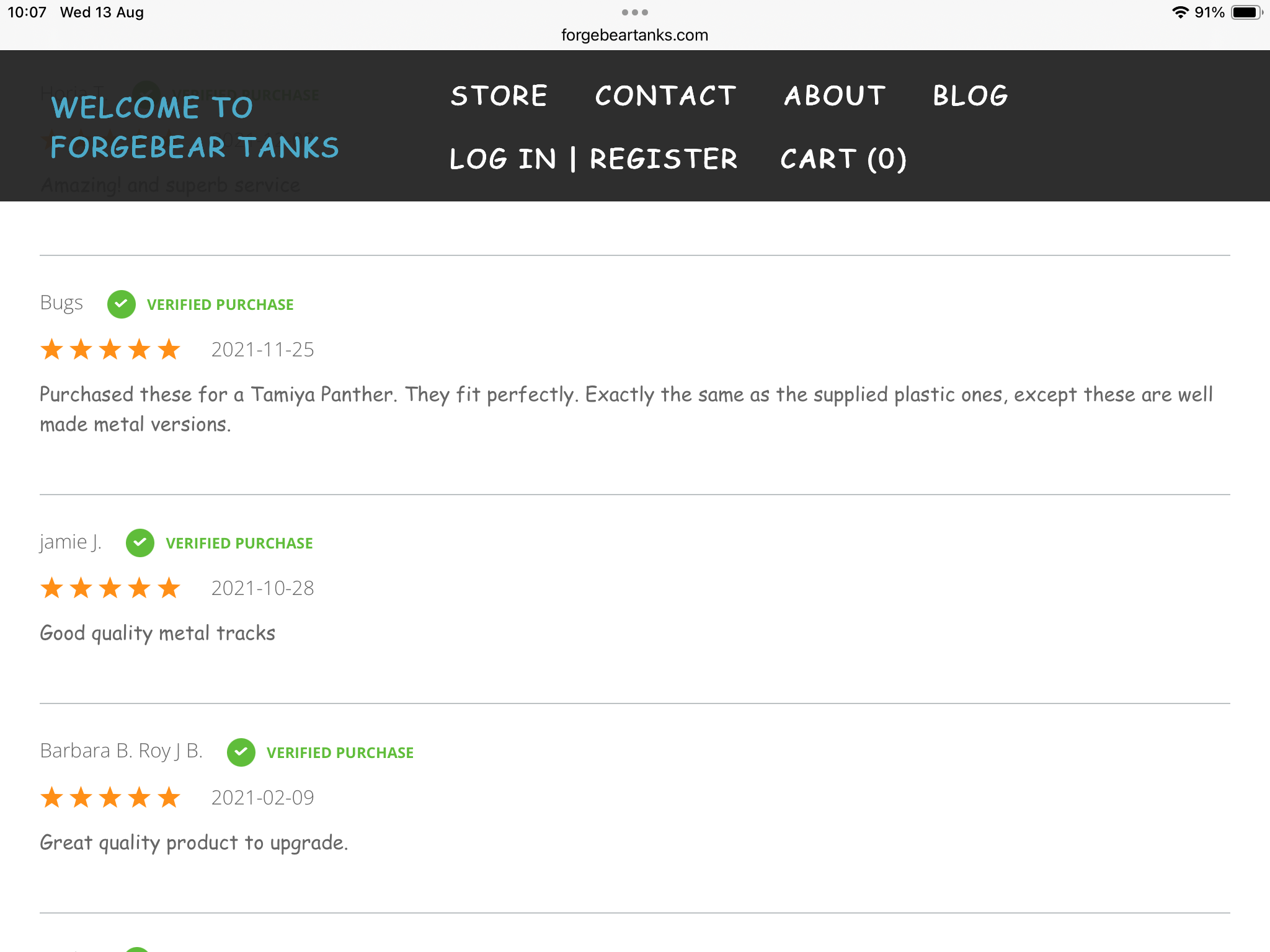

Found these tracks on Forgebear website & a review, maybe ask Dave at Forgebear, he’s always very helpful.
Hope it helps you.
