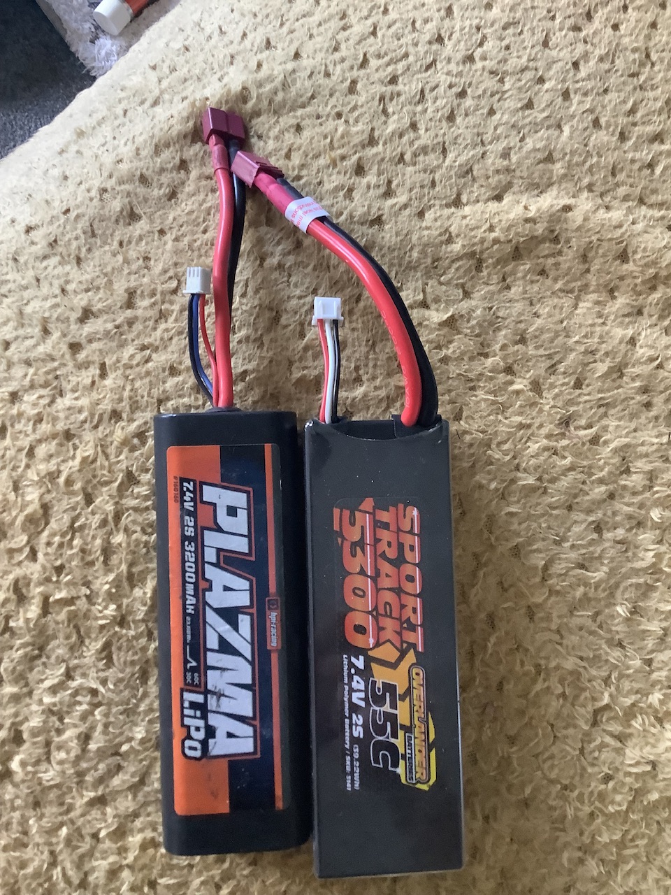

So about to buy my first RC Tank. Looking at the batteries. I see they come with Lithium iron battery. I race Touring cars and use @ cell Lipo batteries.
What batteries are people using and is the battery size in dimension the same across the 1/16 scale range?
Many thanks

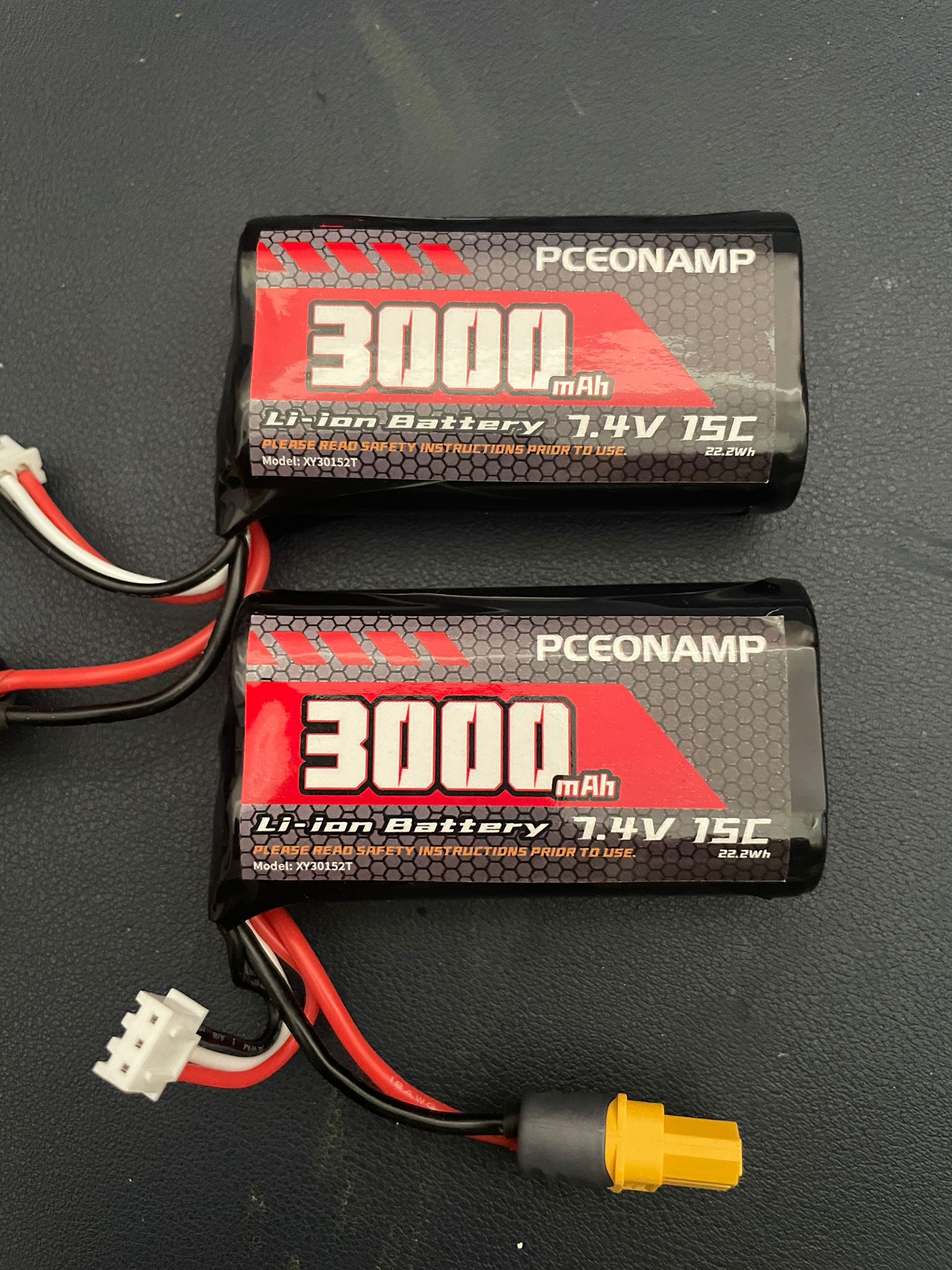

So new batteries arrived. went for a pair of 3000Mah.
worth a try. :thumbup: :thumbup:
